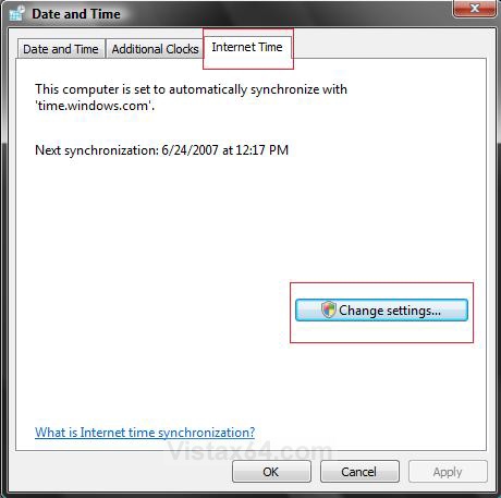

4. Click/tap on the Internet Time tab. (see screenshot below)​
5. Click/tap on the Change Settings button.​

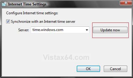

8. To Synchronize the Computer Time with the Internet Time
A) Click on the Update now button. (see screenshot below)​
NOTE: Synchronization must be turned on for this to work in step 7.

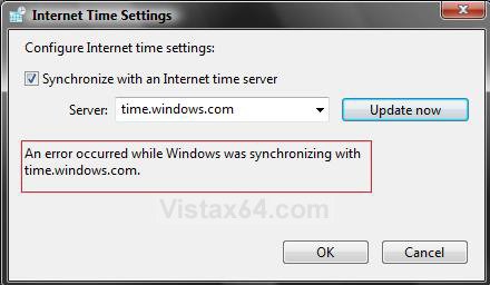

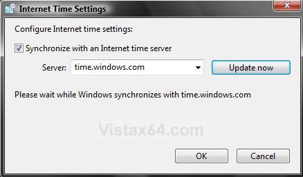

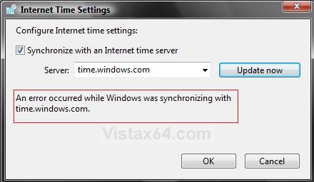

9. You will now see the screenshot below.​
10. If you see this in the screenshot below, then click Update now again to see if it will work this time.​
A) If you still get the error message below, go to step 11.​
B) If you get no error message, then go to step 12.​

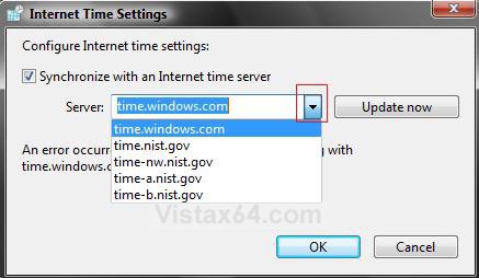

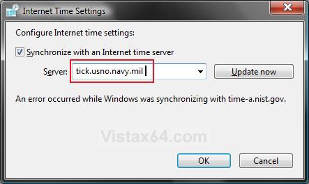

11. To Change the Time Server
A) Click/tap on the drop down arrow and choose another time server. (see left screenshot below)​
OR
B) Type in a new time server name in the field instead. (see right screenshot below)​
C) Click/tap on the Update now button to try the new time server.​
NOTE: You may need to repeat step 11 until you find a time server that will work. If you just cannot get it to sync, then see the WARNING at the top of the tutorial for settings to check that may be preventing it from working.

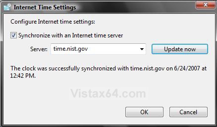

12. If successful, you will see this in the screenshot below.​
13. Click/tap on OK. (see screenshot above)​
14. Click/tap on OK. (see screenshot below step 5)​

My Vista has just started having issues with time updates and I have now tried around 20 different time servers, all get 'an error occurred'. Weird. I have had the problem intermittently in the past and usually another server cured it. I have port 123 allowed through the firewall (McAfee).
I noticed when I returned from vacation yesterday that the clock was still showing DST. I altered it manually but that shouldn't have to be the case.
I'm wondering if this is an ISP issue as my emails are slow in arriving too.
Correction: After a reboot it updated fine....why will remain a mystery.

Hello Peter,
A mystery indeed. The next time it happens, you might try using a different DNS server (ex: Open DNS or Google DNS) to see if it may be your ISP's DNS server acting up.
