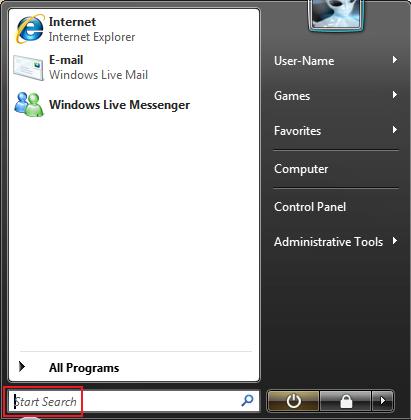

1. Open the Start Menu.​
2. In the white line (Start Search) area, Copy and Paste a command option (A to D) below in bold below that you want to do and press Enter. (See screenshot below)​

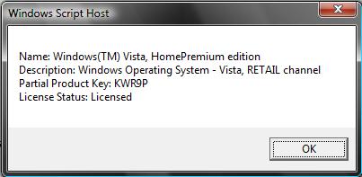

A) slmgr.vbs -dli = To display partial license information. (See screenshot below)​

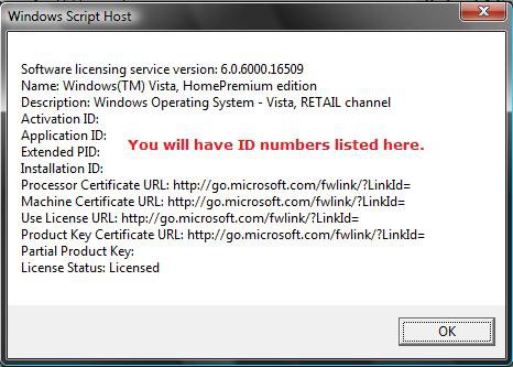

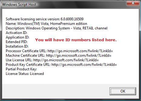

B) slmgr.vbs -dlv = To display detailed license information. (See screenshot below)​

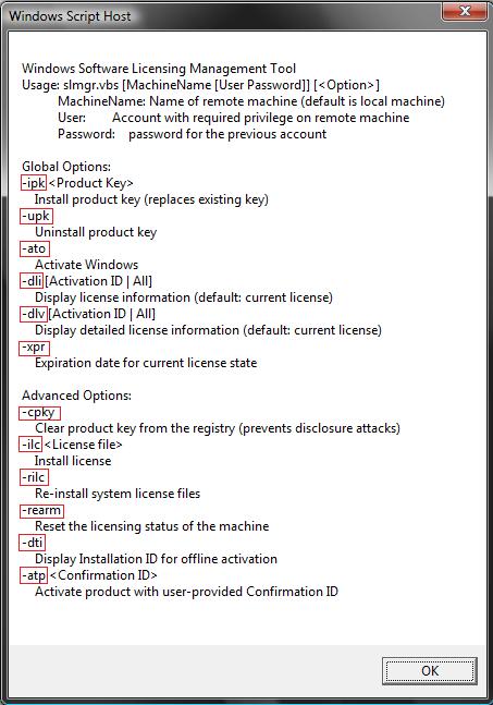

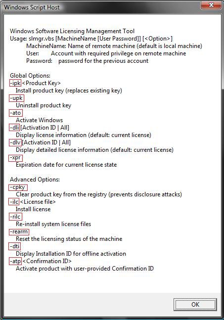

D) slmgr.vbs = To display a complete list of options for license. (See screenshot below)​
