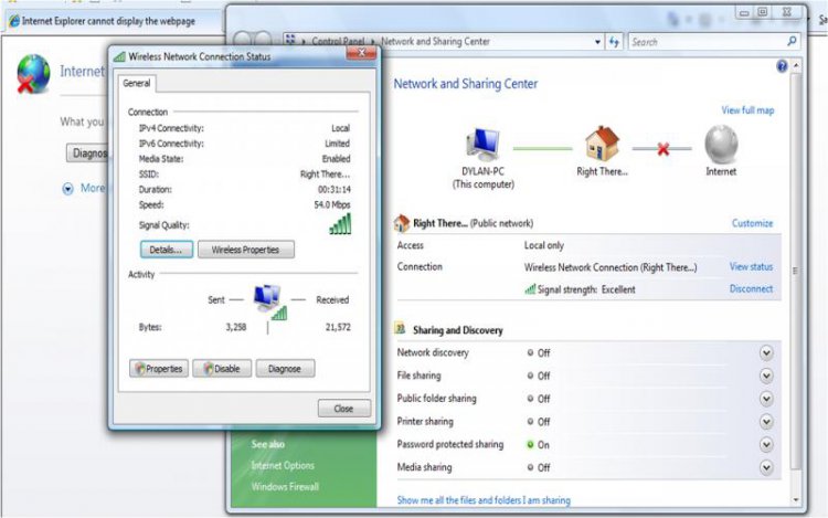

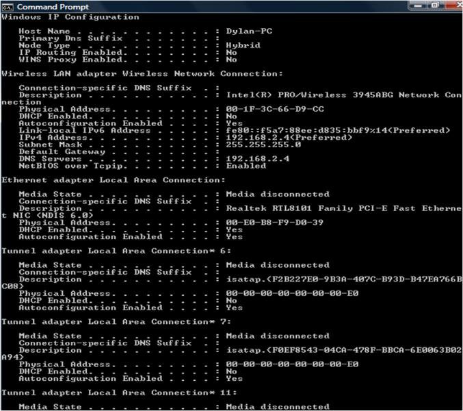

You have no default gateway setup. You need to change your network configuration. Is your internet setup to automatically connect when you connect to the wireless network or do you need to also establish a separate broadband connection?
I believe it is... My knowledge is pretty slim on this. It says that it is connected to my wireless connection but in the network and sharing center says that it is an unidentified network and a red X before the internet. How would I setup a default gateway?

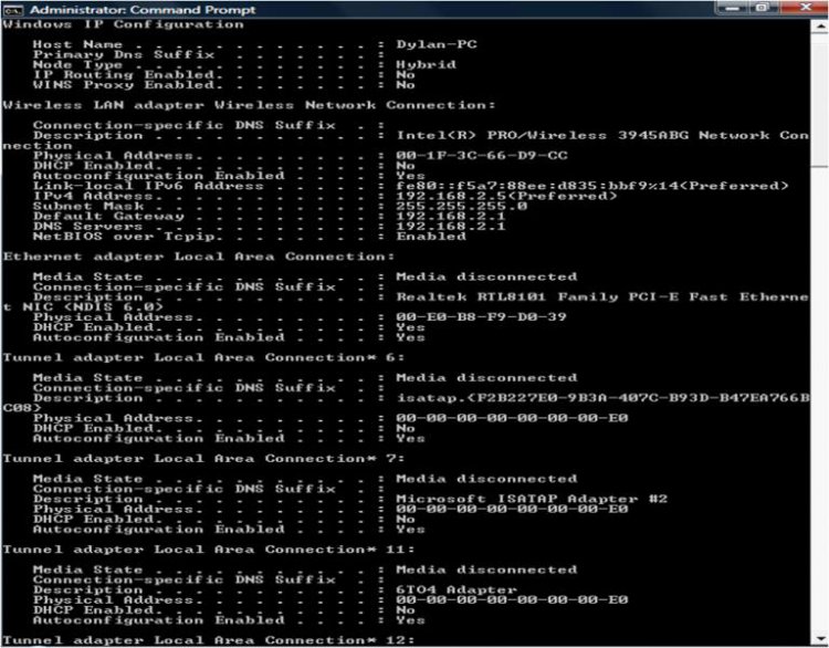

First, turn on Network Discovery on the local connection. You can also turn on the sharing options as well if you want, but I don't think that will affect the internet connection.
Next, do you now have another connection for the Internet (whatever it is called) besides just the local connection you have on the laptop? If not, create one specifically for the internet at your location. If so or then, turn on Network Discovery for it as well and connect to it (it may need to be done separately). Then I think it will work. The IPCONFIG /all looks fine (but it's hard to tell since I don't know how the rest of your network is configured or if those are the correct addresses but they lookk acceptable and are comparable to mine).
