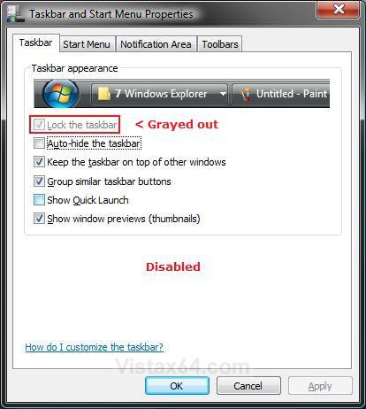

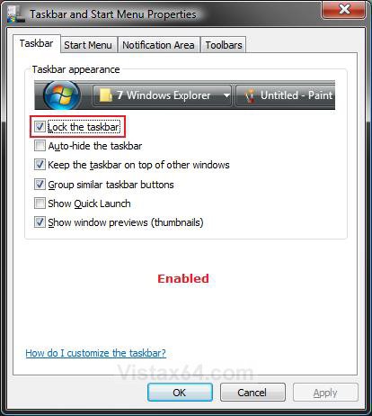

EXAMPLE: Lock the Taskbar Enabled or Disabled in the Taskbar Context MenuNOTE: Notice that Lock the Taskbar is grayed out when disabled.
EXAMPLE: Lock the Taskbar Enabled or Disabled in Taskbar and Start Menu Properties
NOTE:

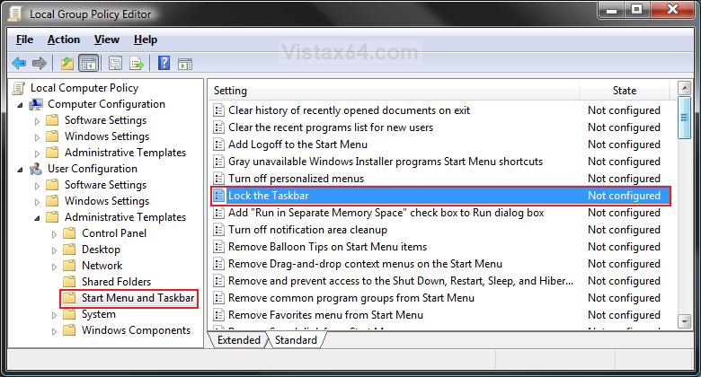

2. In the left pane, click on User Configuration, Administrative Templates, and Start Menu and Taskbar. (See screenshot below)​

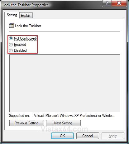

3. In the right pane, right click on Lock the Taskbar and click on Properties. (See screenshot above)​
4. To Enable Lock the Taskbar
A) Dot Disabled or Not Configured and click on OK. (See screenshot below step 5A)​
B) Go to step 6.​
5. To Disable Lock theTaskbar
A) Dot Enabled and click on OK.​

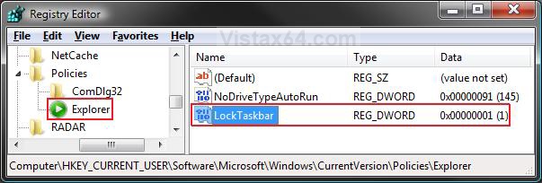

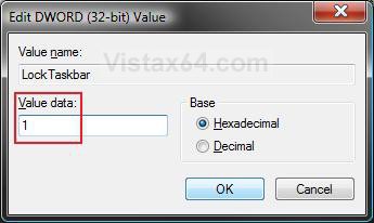

Manually in Registry Editor
1. Open the Start Menu.​
5. To Disable Lock the Taskbar
A) In the right pane, right click on a empty area and click on New and DWORD (32-bit) Value. (See screenshot above)​
B) Type LockTaskbar and press Enter.​

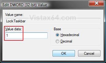

C) Right click on LockTaskbar and click on Modify. (See screenshot below)​
F) Go to step 7.​

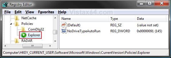

6. To Enable Lock the Taskbar
A) In the right pane, right click on LockTaskbar and click on Delete. (See screenshot above)​
7. Close regedit.​
