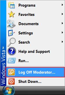

EXAMPLE: Before and After Normal Start Menu
EXAMPLE: Before and After Classic Start Menu

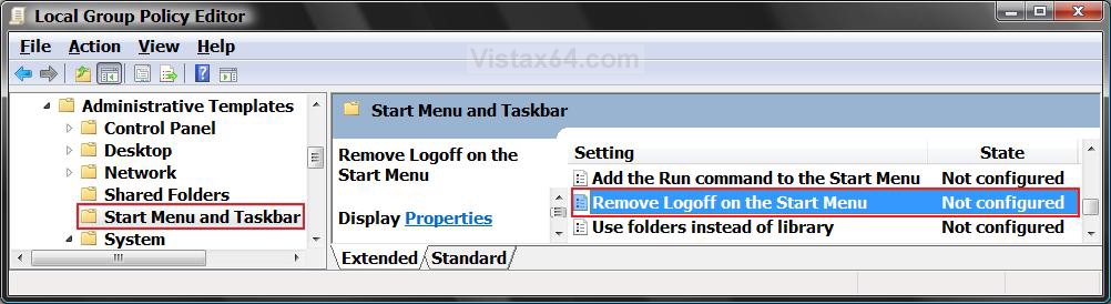

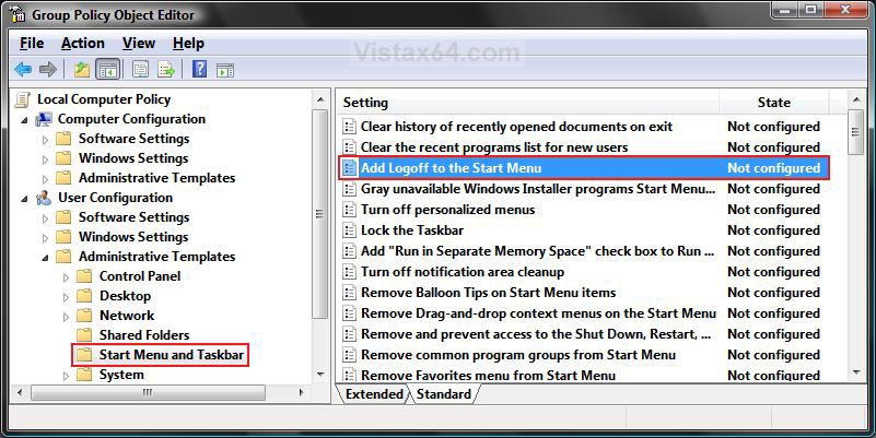

1. Open the all users, specific users or groups, or all users except administrators Local Group Policy Editor for how you want this policy applied.
2. In the left pane, click on User Configuration, Administrative Templates, Start Menu and Taskbar. (See screenshot below step 3)

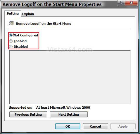

3. In the right pane, right click on Remove Logoff on the Start Menu and click on Properties. (See screenshot below)
4. To Add Normal Start Menu Log Off
A) Dot Disabled or Not Configured and click on OK. (See screenshot below step 5)
B) Go to step 10.
5. To Remove Normal Start Menu Log Off
A) Dot Enabled and click on OK.
B) Go to step 10.

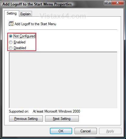

8. In the left pane, click on User Configuration, Administrative Templates, Start Menu and Taskbar. (See screenshot below step 7)
9. In the right pane, right click on Add Logoff to the Start Menu and click on Properties.
10. To Remove Classic Start Menu Log Off
A) Dot Disabled or Not Configured and click on OK. (See screenshot below step 9)
11. To Add Classic Start Menu Log Off
12. Close the Local Group Policy Editor window. Your done.

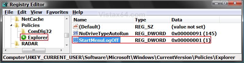

1. Open the Start Menu, then type regedit and press Enter.
2. If prompted by UAC, then click on the Continue.
3. In regedit, navigate to the location below. (See screenshot below step 4C)
NOTE: If you do not have Explorer, then right click on Polices and click on New and Key, then type Explorer and press Enter.
OPTION ONE:

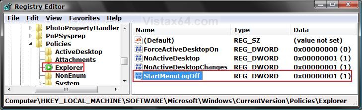

4. To Remove Log Off from the Normal Start Menu

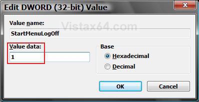

A) In the right pane, right click on a empty area and click on New and DWORD (32-bit) Value. (See screenshot below)
B) Type StartMenuLogOff and press Enter.
C) Right click on StartMenuLogOff and click on Modify. (See screenshot below)
D) Type 1 and click on OK. (See screenshot below)
5. To Add Log Off to the Normal Start Menu
A) In the right pane, right click on StartMenuLogOff and click Delete. (See screenshot below step 4C)
B) Click on Yes to confirm deletion.
C) In regedit, go to: (See screenshot below)
HKEY_LOCAL_MACHINE\SOFTWARE\Microsoft\Windows\CurrentVersion\Policies\Explorer
D) In the right pane, repeat steps 5A and 5B if StartMenuLogOff is there to.
6. Close regedit.
7. Log off and log on, or restart the computer to apply the changes.

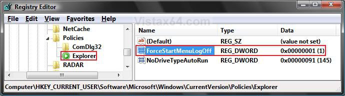

8. To Add Log Off to the Classic Start Menu
NOTE: Repeat steps 1 to 3 above in OPTION ONE.

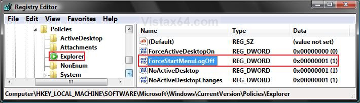

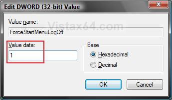

B) Type ForceStartMenuLogOff and press Enter.
C) Right click on ForceStartMenuLogOff and click on Modify. (See screenshot below)
