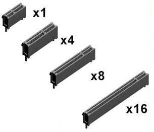

Are you sure that you have the card in the correct slot? Is it a pci-e x16 slot designed for graphics cards? Did you connect any additional power cables?

That doesn't answer my questions.
