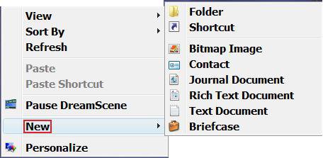

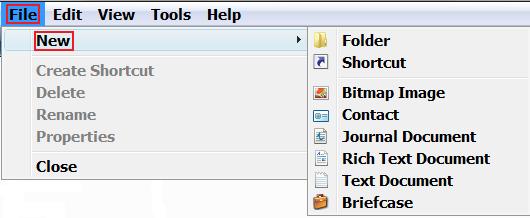

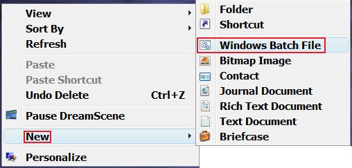

EXAMPLE: Context menu New menu Items Before (Default) and After

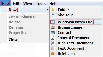

EXAMPLE: File menu New menu Items Before (Default) and After

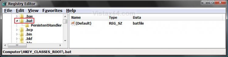

4. In regedit, go to:​
NOTE: Go to the key of the file extension (left pane) of the item you want to add to the New menu.​
HKEY_CLASSES_ROOT\(File Extension)
FOR EXAMPLE: For a New Batch File, go to (.bat) : (See screenshot below)​
HKEY_CLASSES_ROOT\.bat

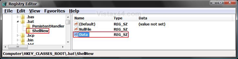

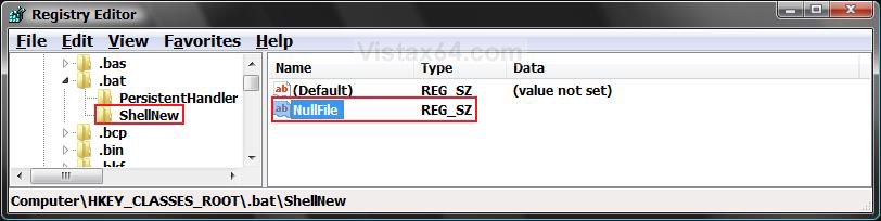

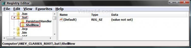

5. In the left pane, right click on the file extension (EX: .bat) and click on New and Key.​
6. Type ShellNew and press Enter. (See screenshot below)​
Option One
To Add or Remove a Blank New Item
7. To Add a Blank New Item
NOTE: This will create a new blank (no content) file of the file extension.​
A) In the right pane, right click on a empty area and click on New and String Value. (See screenshot below step 6)​
B) Type NullFile and press Enter. (See screenshot below)​

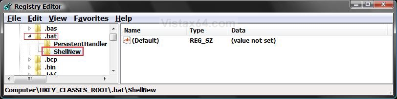

8. To Remove the Blank New Item or Already Existing Item
A) In the left pane of the file extension, right click on ShellNew and click on Delete. (See screenshot above)​
NOTE: To just hide it instead to make it easy to restore again later if you wanted, right click on ShellNew and click on Rename. Rename it to ShellNew*. To unhide it, just remove the * from the name.

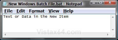

9. To Add a New Item with Content or Data
A) Do step 7 first.​
NOTE: This will create a new file of the file extenstion with content or data the you will enter in step D below.​
EXAMPLE: When you right click on the created New item and click Edit, you will have the content you added in it.​
B) In the right pane, right click on a empty area and click on New and String Value. (See screenshot above)​

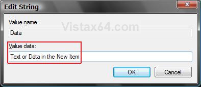

C) Type Data and press Enter. (See screenshot below)​
D) In the right pane, right click on Data and click on Modify.​
E) Type in the Text or Data content that you want the New item to always have when created and click on OK. (See screenshot below)​

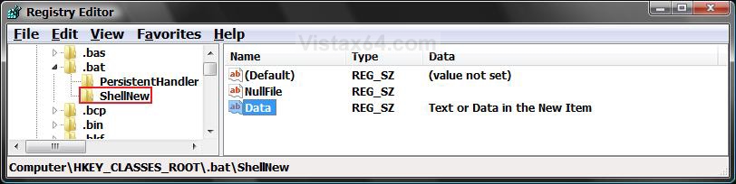

F) You should now see something like this. (See screenshot below)​

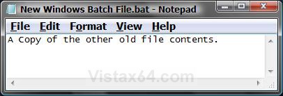

11. To Add a New Item that is a Copy of Another File -
WARNING: This will override step 7 and 9, so you will need to choose to do either those steps or this step.​
NOTE: This will create a new file of the file extension that is a copy of the file you will specify in step 11D below.​
EXAMPLE: When you right click on the created New item and click Edit, you will have the copied content of the file you chose.​

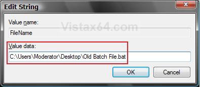

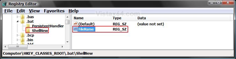

B) Type FileName and press Enter. (See screenshot below)​

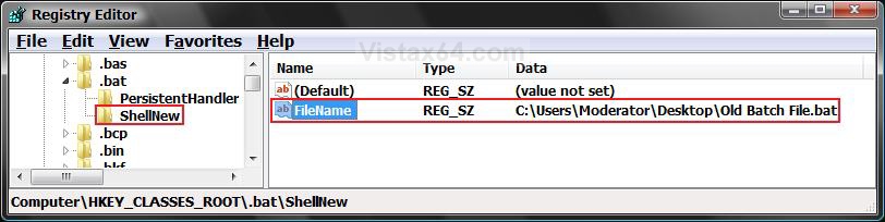

C) In the right pane, right click on FileName and click on Modify.​
D) Type in the full path of the file you want copied and click on OK. (See example screenshot below)​
NOTE: If you add the file you want copied into C:\Windows\ShellNew , then you will just need to type the name of the file instead. (EX:Old Batch File.bat)​
WARNIING: The file you want copied must have the same file extension.​
E) You should see something like this now. (See screenshot below)​

It's a pretty neat tutorial. However, how do I remove the unwanted context and files that are already there? Example, my New Menu consists of the following:
*Folder
*Shortcut
*Contact
*Microsoft Office Word Document
*Journal Document
*Microsoft Office Powerpoint Presentation
*Text Document
*Microsoft Office Excel Worksheet
*Compressed (zipped) Folder
*Briefcase
Any help to remove some of the unwanted would be greatly appreciated.

Hi Bennys,
You will just need to go to the file extension for that New item instead in the tutorial, then right click on it's ShellNew and click on Rename. Rename it to ShellNew*. :geek:
Hope that helps,
Yes, it will be at the same HKEY_CLASSES_ROOT\(File Extension) location.
You can see what file extension they are by temporarily creating a new one to see the extension on it. This will show you how to see the file extensions once the new file is created.
