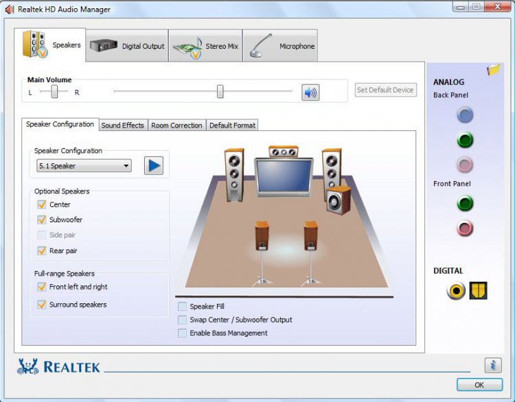

There is a workaround for this which involves setting some options in the HD control panel. To get to these options, click the start orb, 'Control Panel' and 'Additional Options'. Next, click 'Realtek HD Audio Manager'. This should open as shown in the image below. Select 'Speakers' and 'Speaker Configuration' if not already selected. In 'Speaker Configuration', select '5.1 Speaker'.
attachment.php
This shows the default 5.1 setup.
attachment.php

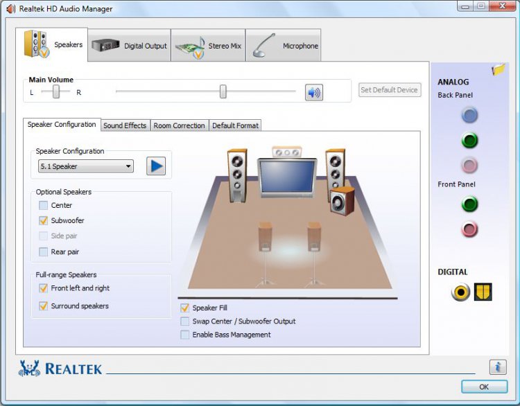

To change it to a 2.1 setup, you need to deselect the 'Optional Speakers' as shown above. The signals will then be fed as follows:
Rear Left > Front Left
Rear Right > Front Right
Center > Balanced between Front Left and Front Right
The Subwoofer will behave as normal.
