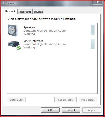

Seems to be a common problem. I used to connect my HP Pavilion dv9260nr Notebook to my Sharp Aquos LCD tv through an HDMI cable and got audio and video w/ no problems. About 2 months ago I reinstalled Vista Ultimate x64. I haven't tried to reconnect until recently and now I get video but no audio.
I have tried to set SPDIF Interface to default like I used to but it doesn't work. You can see the green "mixer" bar moving, but I can't hear anything. Also, when it's set to default the configure box is greyed out.
I have the latest Conexant High Definition Audio Driver, 4.33.1.61.
I also have Vista Codec pack v511 installed.
Seems like I need to "enable" hdmi somewhere but I can't find anywhere to. Any ideas?
Thanks for any help!

Hello,
I'm not sure if I can help here, but I have clean installation of Vista and
found little difference in my Sound window than your one. I will try to explain
what I mean.
Go to Control Panel/Hardware and Sound/ Sound then click Manage Audio Devices.
In this window you should find three items:
-Digital Output Device (HDMI)
-Speakers/Headphones
-Digital Output Device (SPDIF Out)
From your attached image, looks like, you don't have Digital Output Device (HDMI),
do you?. But if you got it, right click it and set it as the Dafault, also check
it and click on Properties, "Enable" the device usage first, then under Levels tab,
check if the volume level is all the way up.
Also, in the Device Manager,I found two devices....High Definition Audio Device
and in my case SigmaTel High Definition Audio CODEC. This first one is just for
HDMI audio. By the way, audio drivers are still the same that OEM provided.
You already try set the SPDIF interface to Default, but click Supported Format
tab and try to check in the Microsoft WMA Audio, and at the same time deselect
the other ones. Maybe, this will help.
Cheers...

If you click on the background of that window showing your speakers, there is a context menu that allows you to see disabled devices. Put a checkmark there, and when your HDMI shows up you can right click it and choose to enable it and if you want, make it the default device.

I had the exact same problem. Before you start messing around uninstalling devices, it may have just disabled itself somehow.
Try right clicking anywhere on the playback tab in the sound box within control panel. An option appears "show disabled devices". You might be able to "enable" from this screen.
