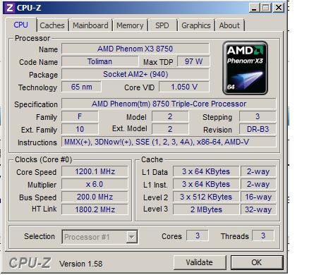

Yup, you have an am2 socket cpu, which is compatible with any am style setup.

You dont have a 940 per say. You have the 940 model cpu, which is an am2 socket cpu.
A 939 socket is a athlon unicore chip from bout 4yrs ago, so no don't trade it.
