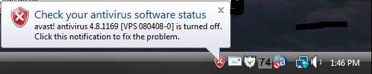

EXAMPLE: Notification Area Balloon Tips Enabled and Disabled
NOTE:
For this example, I disabled my antivirus program to trigger a notification area balloon tip for it.

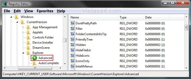

Manually in Registry Editor
1. Open the Start Menu.​

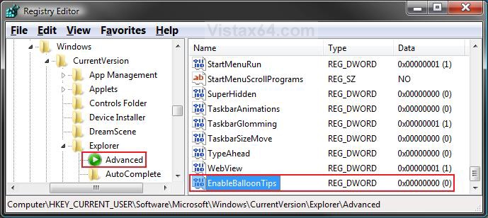

HKEY_CURRENT_USER\Software\Microsoft\Windows\CurrentVersion\Explorer\Advanced
5. To Disable Notification Area Balloon Tips
A) In the right pane, right click on a empty area and click on New and DWORD (32-bit) Value. (See screenshot above)​
B) Type EnableBalloonTips and press Enter. (See screenshot below)​
C) Go to step 7.​
6. To Enable Notification Area Balloon Tips
A) In the right pane, right click on EnableBalloonTips and click on Delete. (See screenshot above)​
7. Close regedit.​
8. Log off and log on, or restart the computer to apply the changes.​

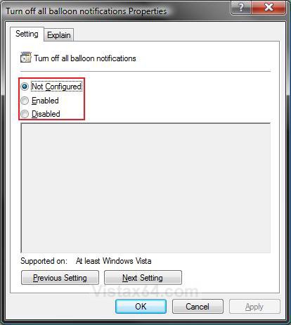

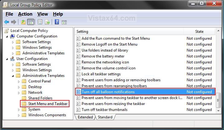

2. In the left pane, click on User Configuration, Administrative Templates, and Start Menu and Taskbar. (See screenshot below)​
3. In the right pane, right click on Turn off all balloon notifications and click on Properties. (See screenshot above)​
4. To Enable Notification Area Balloon Tips
A) Dot Disabled or Not Configured and click on OK. (See screenshot below step 5A)​
B) Go to step 6.​
A) Dot Enabled and click on OK.​

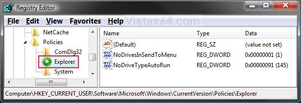

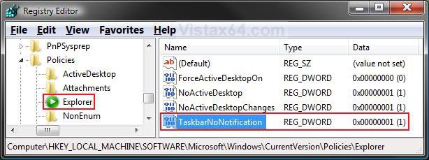

NOTE: If you do not have Explorer, then right click on Policies and click on New then Key and type Explorer and press Enter.​

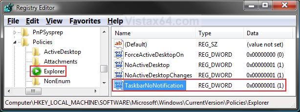

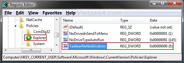

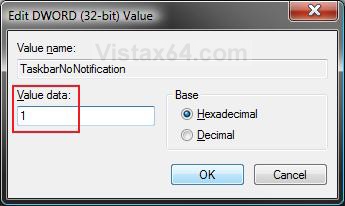

B) Type TaskbarNoNotification and press Enter. (See screenshot below)​
C) Right click on TaskbarNoNotification and click on Modify.​
F) Go to step 7.​
A) In the right pane, right click on TaskbarNoNotification and click on Delete. (See screenshot above)​
HKEY_LOCAL_MACHINE\SOFTWARE\Microsoft\Windows\CurrentVersion\Policies\Explorer
D) In the right pane, repeat steps 6A and 6B if TaskbarNoNotification is there to.​

A big help, thanks. However... this directory location was incorrect for my machine: "HKEY_CURRENT_USER\Software\Microsoft\Windows\CurrentVersion\Policies\Explorer"
I don't have the "Policies" part in there... is this a typo at your end or just a setting at mine? Either way I'm sorted so just letting you know for other users who might be in the same situation as me.
Thanks again!
Brink
Staff member
mvp
Hi BlovvMe,
Policies is usually there by default unless removed by something. Usually it is Explorer that folks do not have by default. Strange. I'm glad to hear that you got it sorted though. I added some instructions for Explorer that can also be used for Policies to help with this. Thank you for bringing this up.
