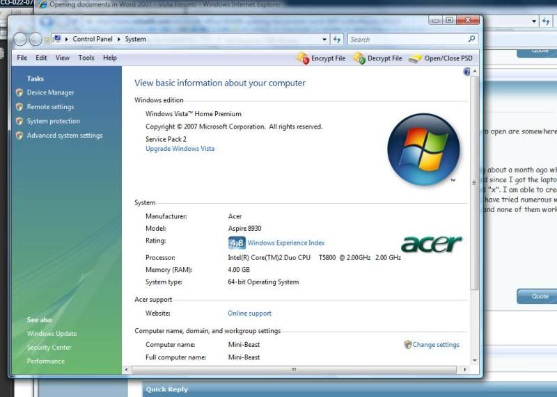

Ugh... I hope I'm wrong, but I've seen reviews that you only have 512Megs of RAM.
Take a screenshot of the systems page like mine:
It'll help if you aren't able to find the info.
