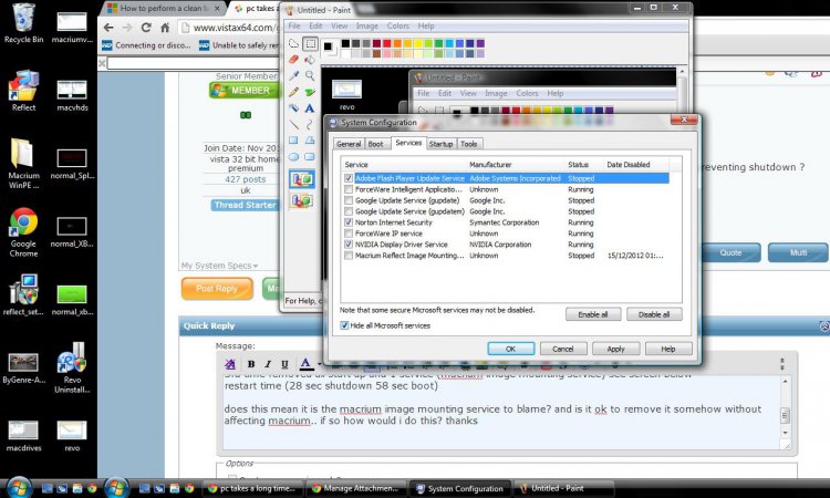

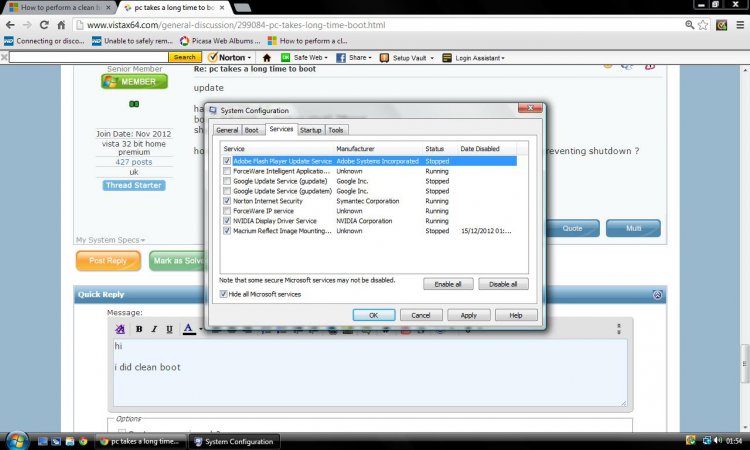

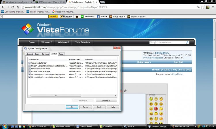

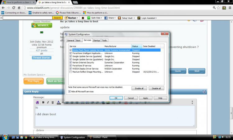

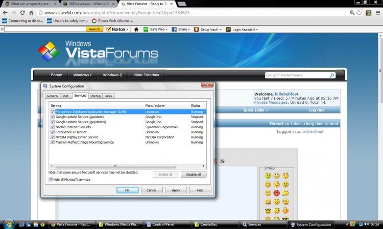

hi
i did clean boot and restart
1st i removed all start up items and all but 4 services see screen below restart time (48 shutdown 110 boot)
this time i disabled macrium image mounting service also.
2nd i removed all start up and all but 3 services see screen below restart time (31 shutdown 101 boot)
this time i enabled all services but macrium image mounting service i left that disabled
3rd time removed all start up and 1 service (macrium image mounting service) see screen below
restart time (28 sec shutdown 58 sec boot)
does this mean it is the macrium image mounting service to blame? and is it ok to remove it somehow without affecting macrium.. if so how would i do this? thanks
