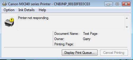

When trying to print test page I get "Printer Not Responding" with my Canon Pixma MX340. All other computers on the wireless network set up fine and all print.
This is not a new issue to my computer. My previous printer was a wireless HP 7200 and it quit printing about 3 weeks ago. I had a Vista update auto install and my computer wouldn't work. I had to restore to an earlier date. Since then the printer doesn't respond.
I've reinstalled the drivers directly from the Canon site.
Any help would be appreciated.

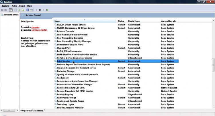

I'm just guessing here, but is your Print Spooler Service turned on?
Computer Management --> Services --> Print Spooler; be sure it is set to "Automatic" via "Properties" and if its turned off you can Start it there.

Thanks Carlo. Spool server was turned on, but McAfee was blocking spoolsv.exe.
Post can be marked as solved.
