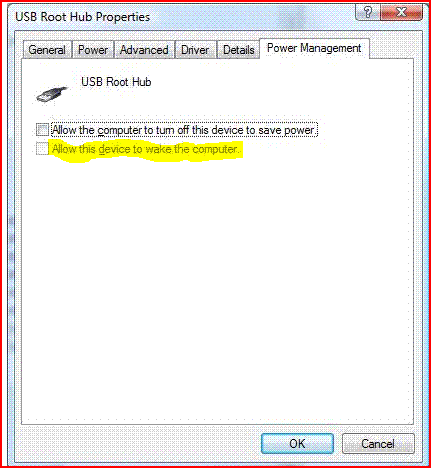

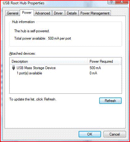

note- this is from hp, but the idea is the same; find the usb root hub in device manager that your printer is on, and uncheck "allow device to wake computer", and check "Allow computer to turn off this device..." (if you want)
"You'll have to check the properties of the USB Root Hubs in the device manager and find out which one the printer is plugged into. it should show the printer name itself, or 'USB Composite Device' instead of USB MAss Storage device as shown in the screenshot below."
Source:USB Printer wakes Vista - Printer, All-in-One Software and drivers - HP Support Forums

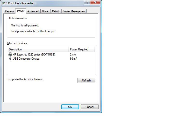

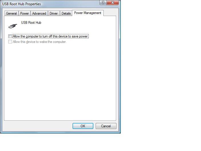

Here are the settings I have in device manager
