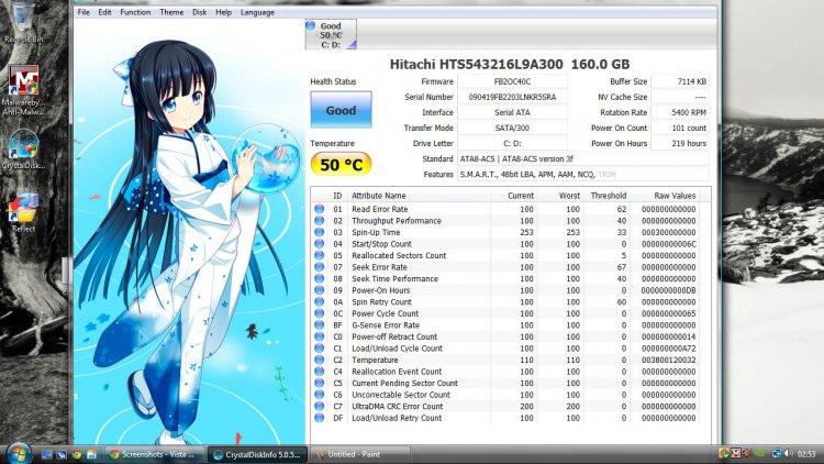

If its still slow, could be a basic driver or hardware. Since you had the problem for a while, I would guess hardware.
Test your hard drive
This will give you a quicke test
Download and give us a screen shot of the results
CrystalDiskInfo - Software - Crystal Dew World
ok will do how do i do screen shots
have only noticed slow down after re-install of os? wich is strange i thought it would speed it up getting rid of all the acer bloatware?

i can appreciate that its hard passing info across in messages etc and especially when ur dealing with someone with limited knowledge such as myself must be hard work.
ok heres screen shot i worked it out in the end never taken a screen shot using mspaint etc before?
