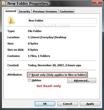

1. Right click on a folder that you want to make the files inside of it read-only, and click on Properties.​

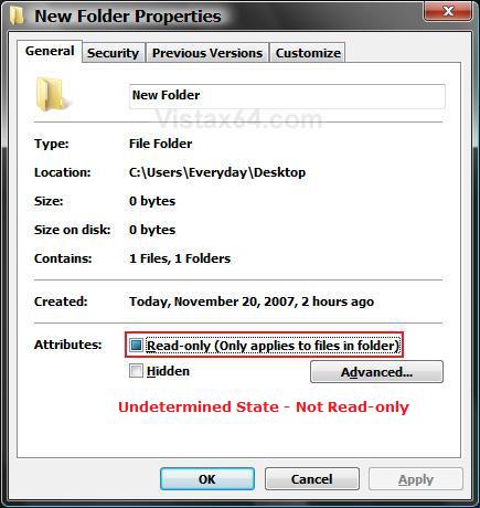

NOTE: The read-only box will always default back to being filled in with blue. A undetermined state of not being read-only. This is not read-only.​
2. Click the General tab. (See screenshot below)​

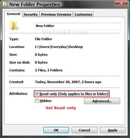

3. To Set Files in Folder as Read-only -
A) Check the Read-only box and click OK. (See screenshot below)​
NOTE: This will only set the read-only attribute for all of the files in this folder and it's subfolders. It does not affect the folder itself. See: Microsoft Help and Support: KB326549

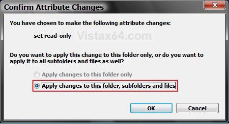

B) Click on OK to confirm changes. (See screenshot below)​

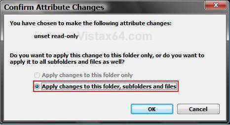

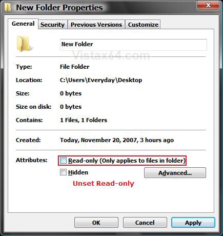

4. To Unset Files in the Folder as Read-only -
NOTE: If the folder is a system folder, then you may need to use METHOD TWO below to remove the read-only attribute of the files in the folder instead.​
A) Click on the Read-only box until it is blank without the blue square. (See screenshot below)​
NOTE: This will unset the read-only attribute for all of the files in this folder and it's subfolders. It does not affect the folder itself.
B) Click on OK. (See screenshot above)​
C) Click on OK to confirm changes. (See screenshot below)​
NOTE: If this is a system folder, then you will have to approve the other pop-ups as well.​

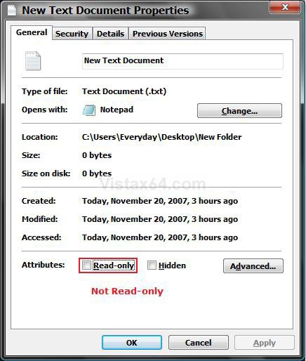

Through a File Properties Page
1. Right click on the file you want to make read-only, and click on Properties.​
2. Click on the General tab. (See screenshots below)​
3. To Set a File as Read-only -
A) Check the Read-only box. (See right screenshot below step 4)​
B) Go to step 5.​
4. To Unset a File as Read-only -
NOTE: If this was a system file, then you may need to use METHOD TWO below to remove the read-only attribute instead.​
A) Uncheck the Read-only box. (See left screenshot below)​
NOTE: To unset read-only for all files in a folder, see step 4 in the above section.
5. Click on OK to apply. (See screenshots above)​

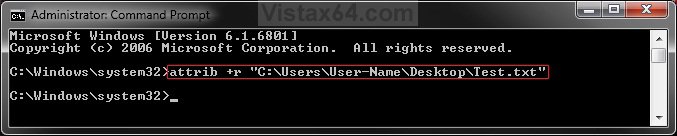

2. To Set a File as Read-only -
A) In the command prompt, type attrib +r "Full path of file" and press Enter. (See screenshot below)​
NOTE: Substitute "Full path of file" for the actual full path of the file.
For example, attrib +r "C:\Users\Moderator\Desktop\Test.txt"
