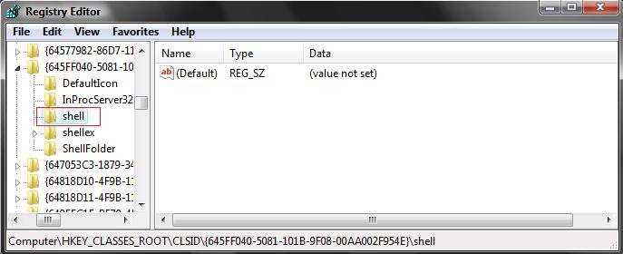

4. In regedit, go to: (See screenshot below step 5)
NOTE: If Shell is not there, then right click on {645FF040-5081-101B-9F0B-00AA002F954E} and click on New and Key. Type Shell and press Enter.
Code:
HKEY_CLASSES_ROOT\CLSID\{645FF040-5081-101B-9F0B-00AA002F954E}\shell

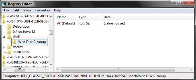

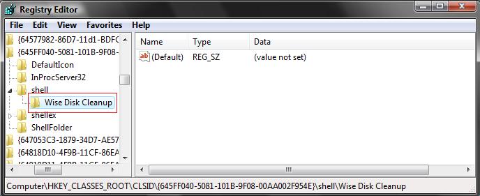

5. In the left pane, right click shell and click on New and Key. (See screenshot below)
6. Type the name you want to appear in the context menu and press Enter. (See screenshot below)
NOTE: This will usually be the name of the program. For example: Wise Disk Cleaner. To REMOVE this, just right click on this key and click Delete and Yes.

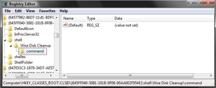

8. Type command and press Enter. (See screenshot below)
NOTE: This must be named command.

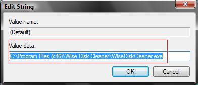

9. In right pane, right click (Default) and click on Modify.
10. Type in the full path of the program .exe file. (See screenshot below)
NOTE: For the example:
C:\Program Files (x86)\Wise Disk Cleaner\WiseDiskCleaner.exe
11. Click on OK to apply.

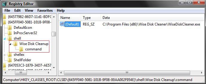

12. The part you just added to the registry should look like this screenshot below.
