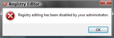

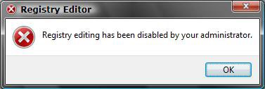

EXAMPLE: Error Message
NOTE:
You get this when you try to run Regedit.exe or a REG file when set to disabled.

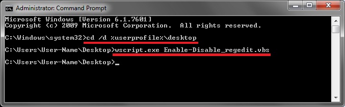

4. In the elevated command prompt, copy and paste the command below and press Enter. (see screenshot below)​
cd /d %userprofile%\desktop
5. In the elevated command prompt, copy and paste the command below and press Enter. (see screenshot above)​
wscript.exe Enable-Disable_regedit.vbs
6. Click on OK. (see screenshots below)​
7. Close the elevated command prompt window.​

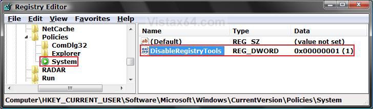

To Manually Disable Regedit Using Registry Editor
WARNING: Once you disable regedit and close the registry, you will not be able to enable regedit again through the registry or from a REG file. See OPTION ONE or OPTION FOUR to be able to enable regedit again.
1. Open the Start Menu, then type regedit and press Enter.​
2. If prompted by UAC, click on Continue (Vista)or Yes (Windows 7).​

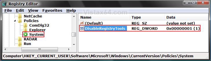

3. In regedit, navigate to the location below. (See screenshot below step 5)​
NOTE: If you do not have System, right click on Polices, click on New and Key, then type System and press Enter.​
HKEY_CURRENT_USER\Software\Microsoft\Windows\CurrentVersion\Policies\System
4. To Disable Regedit
A) In the right pane, right click on a empty area and click on New and DWORD (32-bit) Value. Type DisableRegistryTools and press Enter. (See screenshot below step 4)​
5. Right click on DisableRegistryTools and click on Modify. (See screenshot below)​

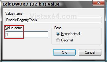

Disable regedit from running silently?
6. To Disable Regedit and Allow Silent Mode
NOTE: See NOTE at the top about Silent Mode.​
A) Type 1 and click on OK. (See screenshot below step 7A)​
7. To Disable Regedit and Prevent Silent Mode
A) Type 2 and click on OK.​
8. Close regedit.​

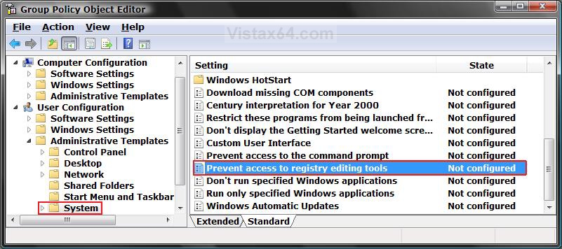

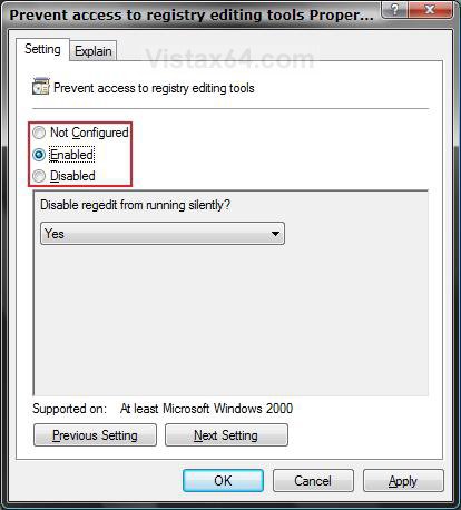

Enable or Disable Regedit Using Local Group Policy Editor
2. In the left pane, click on User Configuration, Administrative Templates, and System. (See screenshot below)​
3. In the right pane, right click on Prevent access to registry editing tools and click on Properties. (See screenshot above)​
4. To Enable Registry Editor
A) Select (dot) Disabled or Not Configured and click on OK. (See screenshot below 5D)​
B) Go to step 6.​
5. To Disable Regestry Editor
A) Select (dot) Enabled. (See screenshot below 5D)​
B) To Allow Silent Mode - Select No. (See screenshot below 5D)​
C) To Prevent Silent Mode - Select Yes. (See screenshot below 5D)​
D) Click on OK. (See screenshot below)​
6. Close the Local Group Policy Editor window. Your done​
