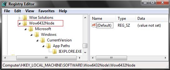

4. In regedit, go to this key: (See screenshot below)​
HKEY_LOCAL_MACHINE\SOFTWARE\Wow6432Node\Wow6432Node
5. In the left pane, right click on Wow6432Node and Delete.​
WARNING: Make sure you only delete this second Wow6432Node, or you will trash your system. If you deleted the first one, then do a System Restore using a restore point dated before doing this.​

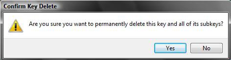

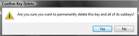

6. Click on Yes to the confirmation pop-up. (See screenshot below)​
