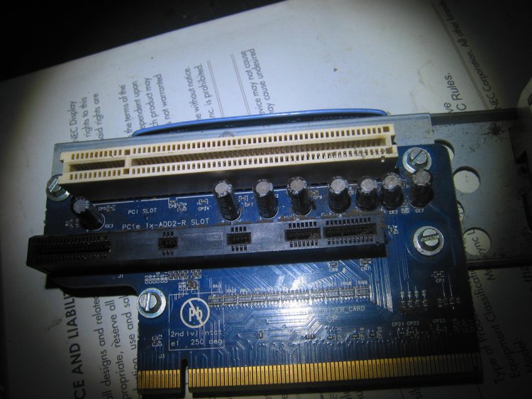

Pics of pci-e x1 slot: PCI-E SLOT — Postimage.org
Pic of my PCI-E x1 slot

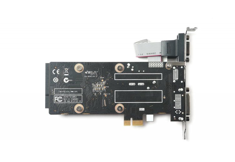

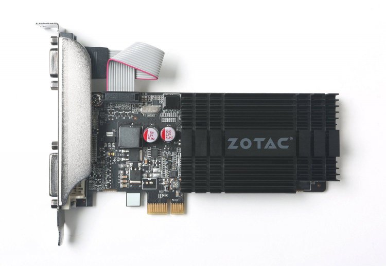

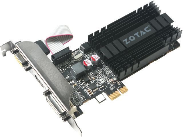

I did find a PCI-E x1 video adapter, actually found two of them, most new Video adapters with 1GB memory use PCI-E x8 or x16. I think you may right about the bandwidth. However I'm sort of puzzled about two different eBay sellers advertising a Zotac GeForce GT 710 DirectX 12 ZT-71304-20L 1GB 64-Bit DDR3. Advertised as a "PCI Express x1" adapter? Perhaps both descriptions are wrong? I emailed both sellers asking them about the PCI Express x1 in their descriptions.
One shows a pic of the video adapter and the pic displays the video adapter with a pci-e x1 interface.
SPECIFICATIONS
NVIDIA GeForce GT 710 GPU
192 CUDA cores
1GB DDR3 memory
64-bit memory bus
Engine clock: 954 MHz
Memory clock: 1600 MHz
PCI Express x 1
Unable to add links for the PCI-e x1 video adapters for sale. Their ebay auction title is
Zotac GeForce GT 710 DirectX 12 ZT-71304-20L 1GB 64-Bit DDR3 PCI Express x1 HDCP

I'll admit I didn't know that there are video cards that use x1 slots since no cards require more resources than a video card however I wouldn't expect much from it since the bandwith for a x1 slot isn't nearly what you get from a x16 slot. PCI Express - Wikipedia That has a comparative table. A converter can be used but that won't change the throughput of the slot. Also in your typical configuration the pci cards and lower throughput pci-e cards connect to the slower end of the chipset, called the south bridge, whereas the x16 connects to the faster end called the north bridge. Northbridge (computing) - Wikipedia In your case the northbridge will be connected to your integrated graphics. A PCI card would be even worse than a pci-e x1. I'm not convinced that you would be any better off with that card than you would be using the integrated graphics but you can try it. You certainly can't expect anywhere near the performance that you would get from a x16 slot. Don't expect to be able to do heavy gaming with that card.
Yeah I think your right and remember reading about south and north bridge.
