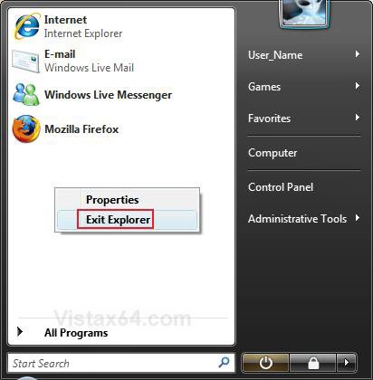

A) Open the Start Menu.​
B) Press and hold Ctrl+Shift and right click on a empty area of the Start menu. (See screenshot below)​
C) Releas Ctrl+Shift and click on Exit Explorer.​

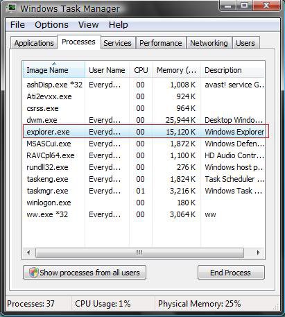

2. To Close Explorer.exe
A) Click on the Processes tab. (See screenshot below)​
B) Click on explorer.exe and click on the End Process button.​

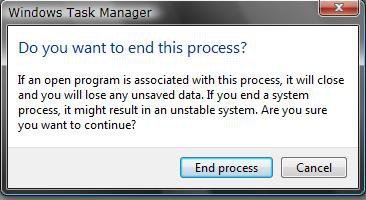

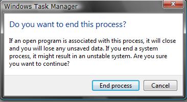

C) Click on End Process in the confirmation prompt. (See screenshot below)​
D) You will now notice that Explorer has stopped.​
NOTE: The taskbar, deskop icons, and any open Windows Explorer windows are now gone.​

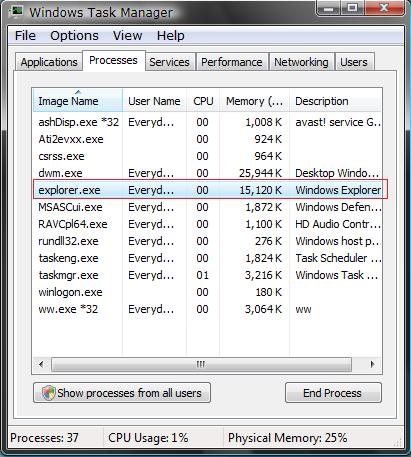

3. To Restart Explorer.exe
A) Click on File in Task Manager. (See screenshot for step 3 above)​

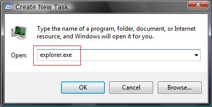

B) Click on New Task (Run...).​
C) Type explorer.exe and click OK. (See screenshot below)​
D) You will notice Explorer restarting.​
NOTE: The taskbar and desktop icons will be back.​

we can gracefully restart the explorer.exe by holding ctrl+shift and rightclick on an empty area on the startmenu and clicking exit explorer!!
Hello Sagarun, and welcome to Vista Forums.
Thank you for sharing. The tutorial has been updated to include this.
