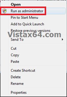

EXAMPLE: "Run as administrator" in Context Menu of Application Files
1. To Restore "Run as administrator" to the Context Menu
NOTE: This is the default setting.​
Restore_Run_as_administrator.reg
download
B) Go to step 3.​
2. To Remove "Run as administrator" from the Context Menu
Remove_Run_as_administrator.reg
download
3. Click on Save, and save the .reg file to the desktop.​
If you do not see a Merge option when you right click on the REG file, then you will need to check in Default Programs to set the reg file extension to have it's Current Default program set as Registry Editor (C:\Windows\regedit.exe). Afterwards, try merging the REG file again.
5. Click on Run, Yes, Yes, and OK when prompted.​
