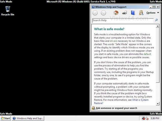

Safe Mode
How to Start Vista in Safe Mode
Safe mode is a troubleshooting option for Windows that starts your computer with a minimal set of drivers and services. If an existing problem does not reappear when you start in safe mode, you can eliminate the default settings and basic device drivers as possible causes.
If your computer automatically starts in safe mode without prompting, a problem with your computer might be preventing Vista from starting normally. If you think the cause of the problem might be a recently installed program or device, then try using System Restore. See: How to Do a System Restore in Vista

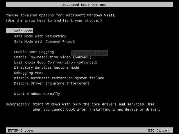

Through Advanced Boot Options
1. Boot into the Advanced Boot Options screen.​
2. Use the arrow keys to select Safe Mode and press Enter. (See screenshot below)​
NOTE: The computer will now start Vista in Safe Mode after you logon.​
3. When done in Safe Mode, Restart the computer from the Start Menu to go back to the normal boot mode.​

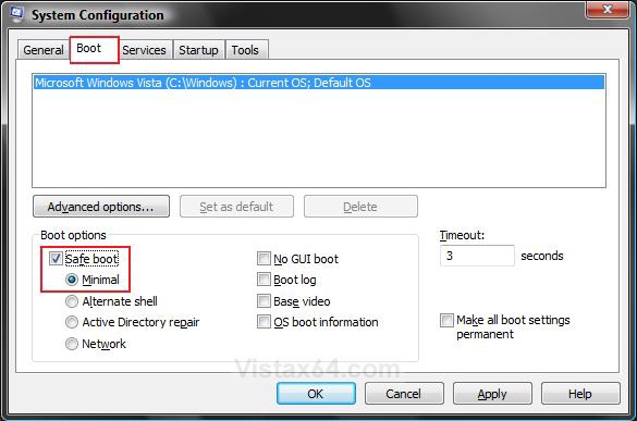

1. To Start Vista in Safe Mode
WARNING: This will set Vista to start into Safe Mode all the time until you set it back to the normal boot mode in step 2 below.​
A) Open the Start Menu.​
B) In the white line (Start Search) area, type msconfig and press Enter.​
C) Click on Continue in the UAC prompt.​
D) Click on the Boot tab. (See screenshot below)​
E) Check Safe boot and dot Minimal.​
F) Click on OK and restart the computer.​

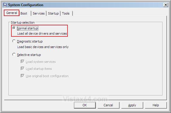

2. To Start Vista Back in Normal Mode
WARNING: Before you can leave Safe Mode, you will need to set msconfig to start Vista back in normal mode.​
C) Click on the General tab. (See screenshot below)​
E) Dot Normal startup.​
NOTE: The computer will now start Vista in normal mode after you logon. If not, then make sure that Safe boot is unchecked and check Make all boot settings permanent (only stays checked until you OK or Apply is checked) and click OK in the screenshot below step 1. You can still make changes to Msconfig later if you want despite the warning. I will confirm it.

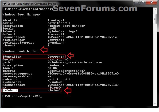

METHOD THREE
Using BCDEDIT Command in a Command Prompt
2. In the command prompt, type the command below and press Enter. (see screenshot below)​
NOTE: Under the Windows Boot Loader sections, make note of the identifier value (ex: {current}) for the OS description (ex: Windows 7) that you want to use in steps 4, 5, or 6 below.​
bcdedit /enum

bcdedit /set {identifier} safeboot minimal
For example: If I wanted to have Windows 7 boot into Safe Mode using the values in the screenshot under step 2, I would type this command below and press Enter.​
bcdedit /set {current} safeboot minimal
