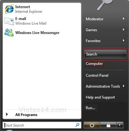

When you install the Vista SP1 it will remove the Search button option from the Start menu. This will show you how to restore the Search button on the right dark side of the Start menu after you installed the Vista SP1.
How to Restore the Start Menu Search Button after Installing the Vista SP1
You will be adding Search button back to the right dark side of the Start menu by replacing either the Help and Support button or Run button with Search. If you prefer to not replace either one of these, then you can create a Search shortcut and Pin it to the left side of the Start menu instead. See: How to Create a Search Desktop Shortcut on Vista

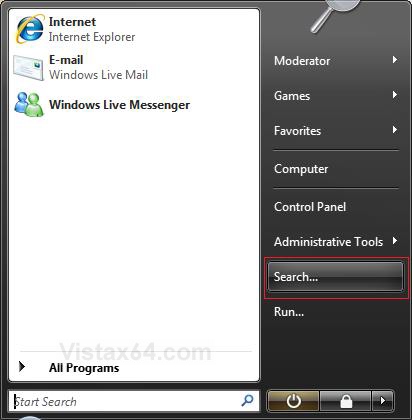

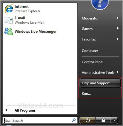

EXAMPLE: Search button in the Start Menu Before and After Installing the Vista SP1

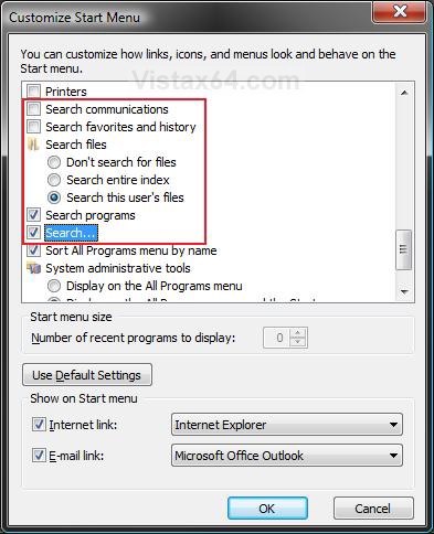

EXAMPLE: Search option in the Customize Start Menu window after Vista SP1
NOTE:
The left screenshot is after installing the Vista SP1. The right screenshot is after you replaced either Run command or Help and Support with Search. This will show you how to enter the Customize Start Menu window: How to Customize the Start Menu in Vista

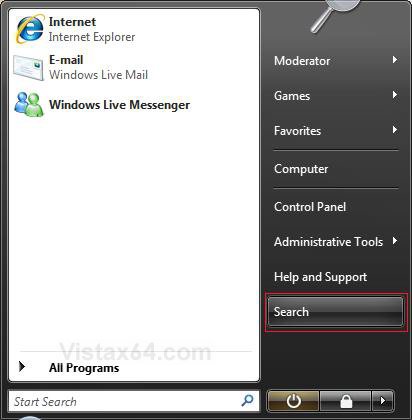

8. Your Start menu will now look like this. (See screenshot below)​

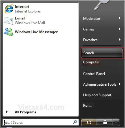

I replaced Run with Search using your reg file on my Dutch OS. That worked fine, I got Search back (in Dutch). Then I changed my mind and decided to put Run back, using your restore file. This failed: I now have neither Search nor Run in the right dark side.
General question: Is it safe to use the register edits on a non-English OS? Specific question: Is there another way for me to get Run back?
Thanks, by the way, for your very clear and useful tutorials.
Brink
Staff member
mvp
Hi A.Translator,
Welcome to Vista Forums.:party:

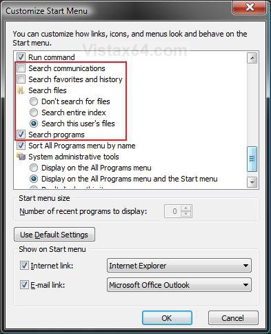

Nice catch you made with the reg file. It was a switch setting in the restore reg file that was set to turn off Run instead of turn on Run automatically. It changed the button back to Run, but left it turned off instead of on. I updated the download to correct this.
You can either check Run again in the Start menu Customize menu, or download the updated Restore_Run.reg file to correct this error.
Thanks for your very quick and helpful reply! I should have thought of customizing the Start Menu myself.

Did you also check the Search box in the Start menu's Customize window?
See the second example in this tutorial above for where to do this at.

Thanks for your very quick reply, Shawn. I don't see a Search box in the Customize window.
