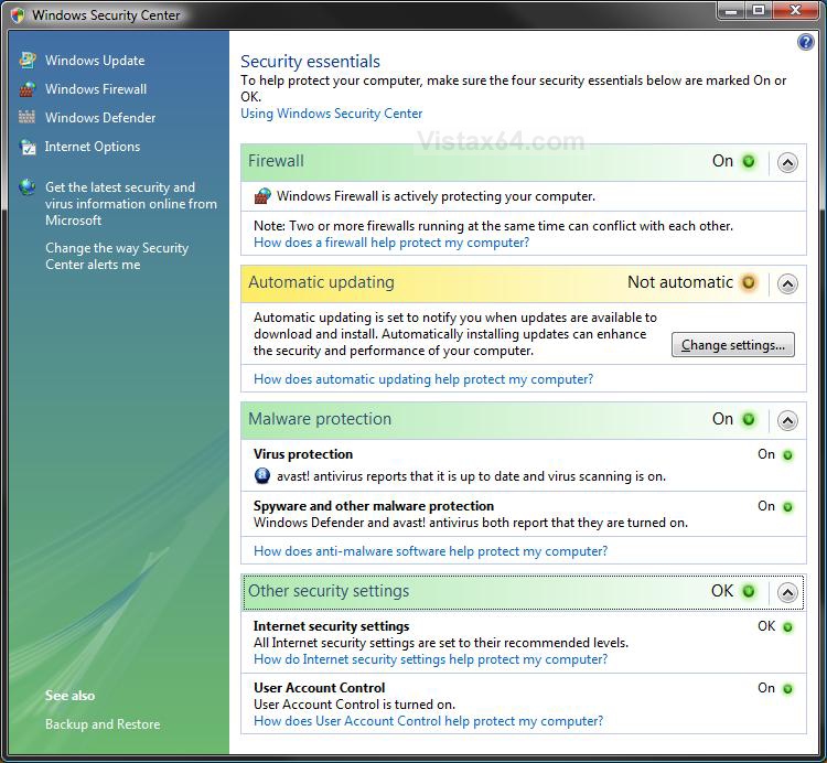

Security Center - Not Reporting Correct Information
How to Fix the Vista Security Center Reporting Incorrect Information
Sometimes the Security Center may show outdated or misleading information or status due to a problem in the WMI repository. This will show you how to rebuild the WMI repository to have the Security Center information reported correctly again.
For example, it may show that you have a antivirus or firewall program still installed and on, when you have actually uninstalled that program.
EXAMPLE: Security Center
NOTE:
You can see the Security Center by opening the Control Panel (classic View) and clicking on the Security Center icon.

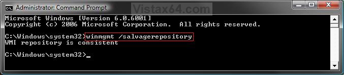

OPTION ONE
To Only Verify the WMI Repository Status
2. In the elevated command prompt, type the command below and press Enter. (See screenshot below)​
winmgmt /verifyrepository
3. You will get either one of these results: (See screenshot above)​
  • WMI repository is consistent - no problems detected.
  • WMI repository is inconsistent - problems detected. You should do OPTION TWO below.
4. Close the elevated command prompt.​
OPTION TWO
To Rebuild the WMI Repository
winmgmt /salvagerepository
  • WMI repository is consistent - no problems as from Option One above. You are done.
  • WMIrepository salvage failed - failed to rebuild WMI repository. Try repeating step 2 again.
  • WMIrepository has been salvaged - WMI repository has been successfully rebuilt.
5. Restart the computer to apply.​
6. Check Security Center to see if the correct information is now being reported.​

What should I do, when I get "Generic Failure" as the outcome at the end of both options?
    Dell Dimension E521
    AMD Athlon(tm) 64x2 Dual Core Processor 4000+, 2104 MHz
    2046 MB
Hello Groffeaston, and welcome to Vista Forums.
Did you use a elevated command prompt and not a regular command prompt?
If you did, then try a System Restore using a restore point dated before this problem. If that still does not help, then you can do a repair (upgrade) install.
    1TB Samsung 990 PRO M.2,
    4TB Samsung 990 PRO PRO M.2,
    Galaxy S23 Plus phone
Yes I did use the elevated command prompt. I can try it again to be doubly sure.
I tried it again and got the same results. Here is what it says:
WMI repository verification failed
Error code: 0x80041001
Facility: WMI
Description: Generic failure
