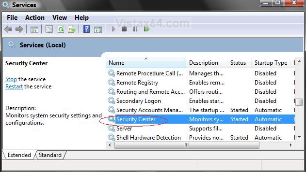

Through Services
3. Open the Start Menu.​
4. In the white line (Start Search) area, type services and press Enter.​
5. Click on Continue in the UAC prompt.​
6. Scroll down and right click on Security Center and click on Properties. (See screenshot below)​

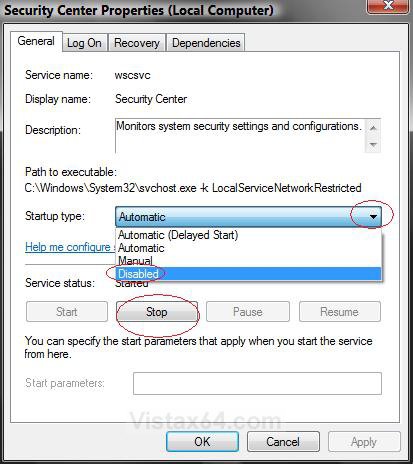

7. To Disable Security Center
NOTE: Be sure to do step 1 above before you disable the Security Center.​
A) Click on the Stop button and wait a second for it to stop. (See screenshot below step 9)​
B) To the right of Startup type, click on the drop down menu arrowand select Disable. (See screenshot below step 9)​
C) Click on the Apply button.​
8. To Enable Security Center
NOTE: Be sure to do step 2 above after enabling the Security Center.​
A) To the right of Startup type, click on the drop down menu arrow and select Automatic. (See screenshot below step 9)​
B) Click on the Apply button.​
C) Click on the Start button.​
9. Click on OK.​

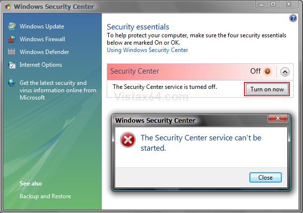

With my computer I go to services and it has security accounts manager but does not have Security Center under it so how can I get that to show up so I can turn security center back on.

nah I had done a clean install just on the Saturday because I was setting up dual boot and I had security center running perfectly now the only thing that shows up under security center is the security center is turned off and the button to turn it on but it says its disabled when i press it, just yesterday I started getting a few problems happening. would u be able to recommend any better antivirus to use besides live one care. I will see scannow if it has fixed the problem I just have to reboot so I will be back in a few mins

I would try uninstalling the Live OneCare first to see if that will return the Security Center service in Services. It will save you a lot of time if it does. You can always reinstall it.
