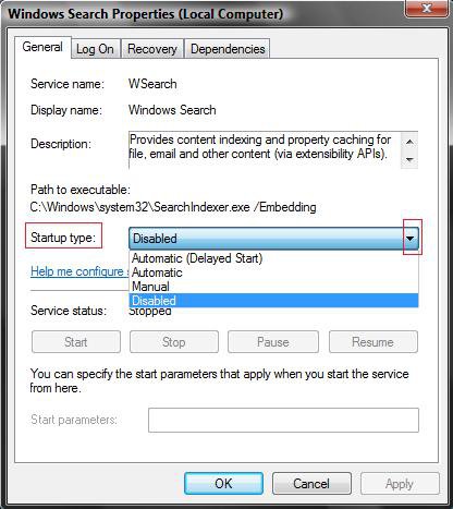

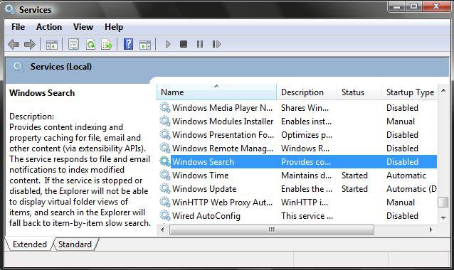

1. Open the Start Menu.
2. In the white line (Start Search) area, type services and press Enter.
3. If prompted, click on Continue in the UAC prompt, or provide the administrator password to approve.
4. Right click on the service you want to disable or enable and click on Properties. (See screenshot below)

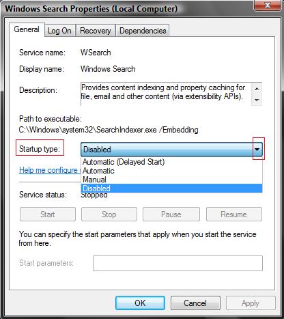

5. To Disable a Service
A) Click on the Stop button and wait a sec for it to stop. (See screenshot below)​
B) Next to Startup type, click on the drop down menuand select Disable.​
C) Click on the Apply button.​
NOTE: If the service will not stop and gives a error, then you will need to restart the computer to stop it after you set it to Disabled and clicked on OK.​
D) Go to step 7.​
6. To Enable a Service
A) Next to Startup type, click on the drop down menu and select Automatic or Manual and click Apply.​
NOTE: See the guides above to help decide.
B) Click on the Start button.​
NOTE: If the Start option is grayed out and will not start, then you will need to restart the computer to start it after you set it to Automatic and clicked OK.
7. Click on OK.
8. Close the Services window.
NOTE: You may need to restart the computer for some changes to the services to take affect.
