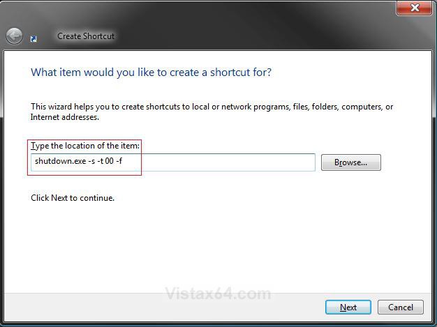

1. Right click on a empty area of the desktop.​
2. Click on New and Shortcut.​

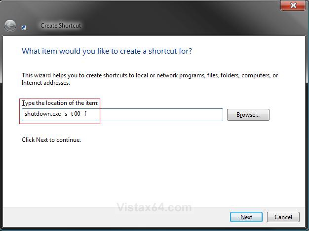

3. Type shutdown.exe -s -t 00 -f into the location field. (See screenshot below)​
NOTE: If you want a delay and notification before shutdown, replace the number 0 at the end above with a number between 0 to 600 in seconds. 0 by itself gives you an immediate shutdown.
EX: If you want shutdown to wait 15 seconds before shutdown, you would type:​
shutdown.exe -s -t 15 -f instead.​
EX: If you want shutdown to wait 5 minutes before shutdown, you would type:​
shutdow.exe -s -t 300 -f instead.​
4. Click on the Next button.​

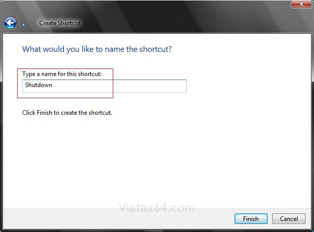

5. Type Shutdown for the name. (See screenshot below)​
NOTE: You can name it anything you would like.
6. Click on the Finish button.​

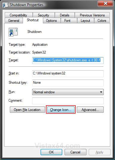

7. Right click on new Shutdown shortcut (On desktop) and click on Properties.​
8. Click on the Change Icon button. (See screenshot below)​

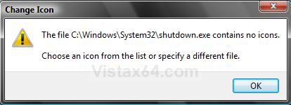

9. Click on OK at the pop-up window. (See screenshot below)​

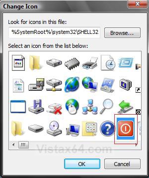

10. Click on the icon highlighted in blue below. (See screenshot below step 11)​
NOTE: If you have your own icon you would rather use, then just navigate to where you have it saved. Vista needs a 256 bit icon for best viewing results.
11. Click on OK.​
12. Click on OK to apply. (See screenshot for step 8)​

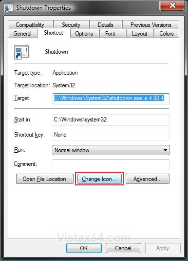

1. Right click on new Shutdown shortcut (On desktop) and click Properties.
2. Under Shortcut tab, click in Target: area. (See screenshot from below step 8 in the above section)
3. Replace the number behind -t with a number in seconds between 0 to 600.
NOTE: 0 by itself gives you an immediate shutdown.
EX: If you want shutdown to wait 15 seconds before shutdown, you would replace it with:​
C:\Windows\System32\shutdown.exe -s -t 15 -f instead.​
NOTE: See Target: in screenshot from below step 8 in the above section.
EX: If you want shutdown to wait 5 minutes before shutdown, you would replace it with:​
C:\Windows\System32\shutdown.exe -s -t 300 -f instead.​
4. Click on OK to apply.
