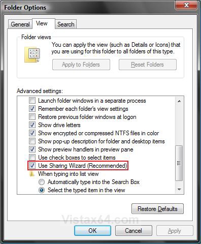

NOTE: This will turn on the Share context menu option and Share tab for the properties window of a item you right click on to set sharing for. This needs to be turned on to do simple file sharing.
1. Open Folder Options.
2. Check Use Sharing Wizard (Recommended). (See screenshot below)
3. Click on OK.

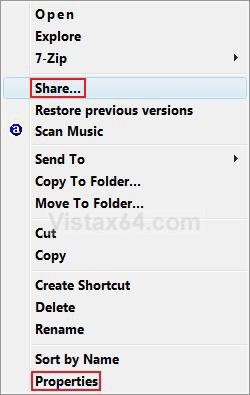

4. Right click on a file or folder.
5. Click on Share. (See screenshot below step 6)
A) Go to step 7 below.
OR

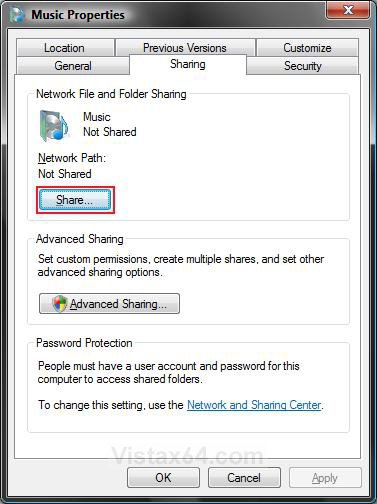

6. Click on Properties.
A) Click on the Sharing tab. (See screenshot below)
B) Click on the Share button.

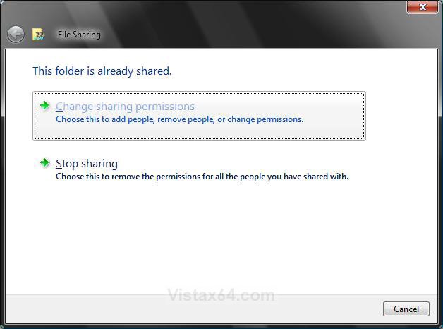

7. If this file or folder is already set to be shared, then: (See screenshot below step 9)
NOTE: If you do not have this set to share yet, then you will see step 10 below instead. Go to step 10.
8. To Change the Sharing Permissions
A) Click on Change sharing permissions. (See screenshot below step 9)
B) Go to step 10.
9. To Stop Sharing the File or Folder
NOTE: This will stop everyone from being able to share this file or folder. Of course, you the owner and any other Administrator account on the computer will still be able to access the file or folder.
A) Click on Stop sharing. (See screenshot below)
B) When it has stopped the sharing, click on Done.

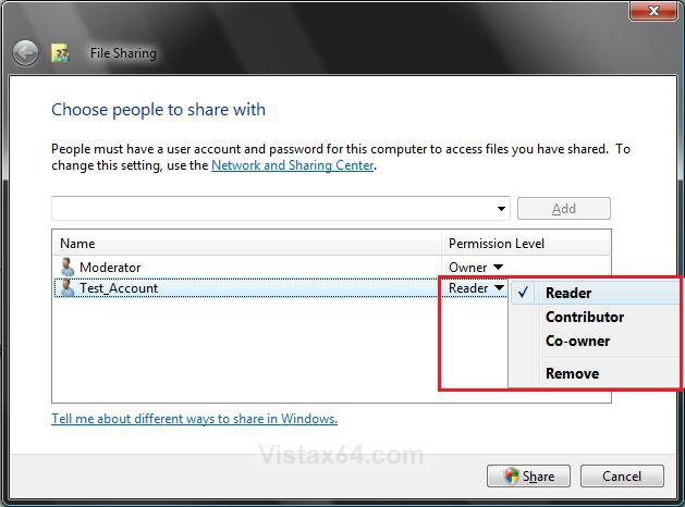

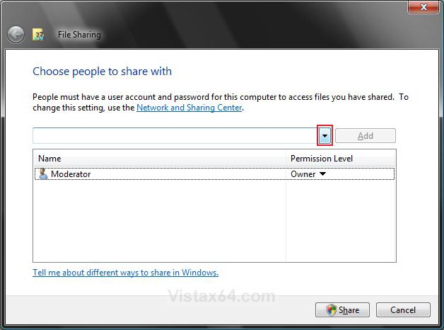

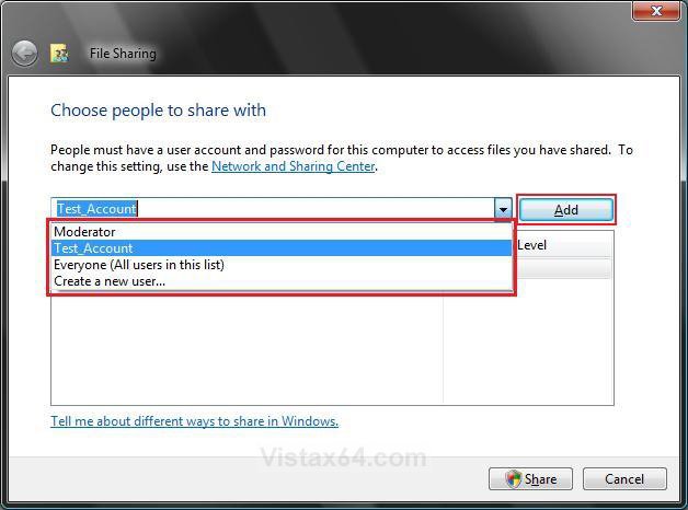

10. To Allow a User or Group to Share this File or Folder
A) Click on the drop down arrow. (See screenshot below)
B) Click on a listed user account or group to select it to allow them to share this file or folder, and click on Add. (See screenshot below)
C) Repeat this step until you added everyone you wanted to allow to share this file or folder.
WARNING: If you have Password Protected Sharing turned off for computers on your network, then you will need to allow the Guest account or Everyone (including the Guest account) to allow computers on the network access to share this file or folder. (See STEP ONE step 7 above)
11. Set the User or Group Share Permission Level
A) Click on the Permission Level arrow for a allowed user or group to see the permission options available. (See screenshot below step 11C)
B) Check the permission level option you want to give to the selected user or group.
Here is what the permission levels mean:
Level
Description
Reader
The user account or group can only view or read files in the shared file or folder.
Contributor
Permit the user account or group to view all files, add files, and change or delete only the files that they added to the folder. If you are sharing a file instead of a folder, then this option will not be available.
Co-owner
Permit the user account or group to view, change, add, and delete any files in the shared folder.
Remove
Removes the user account or group and they are no longer allowed to share the file or folder.

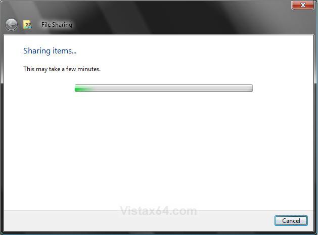

C) Click on the Share button.
D) You will now see this. (See screenshot below)
E) When the file or folder is set to share, you will see this. (See screenshot below step 12)

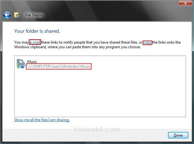

12. Copy the Sharing Network Path Link
NOTE: These links can be used by the computer on a network to connect to your computer using Run or a program to share this file or folder. See STEP THREE step 7 here: How to View and Browse a Computer or Device on a Network in Vista.
A) Click on e-mail to send the links to the allowed users or groups.
OR
B) Click on copy to copy the links to the Clipboard to paste them where you like.
OR
C) Write down the link displayed to store for safe keeping.
D) Click on Done.

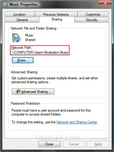

13. Notice that the network path link is now listed on the properties window for the file or folder. (See screenshot below)
A) Click on Close.

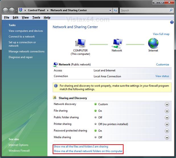

How to See a List of All Shared Files and Folders
14. Open the Control Panel (Classic view).
A) Click on the Network and Sharing Center icon.
B) Go to step 16.
OR
15. Right click on the taskbar Network system tray icon.
A) Click on Network and Sharing Center.
16. Click on the option boxed in red you want to see. (See screenshot below)
NOTE: This will open a Search window and will search and display all of the shared files or folders on your computer for what you selected.
