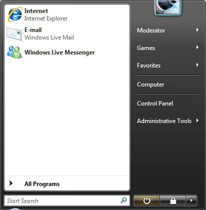

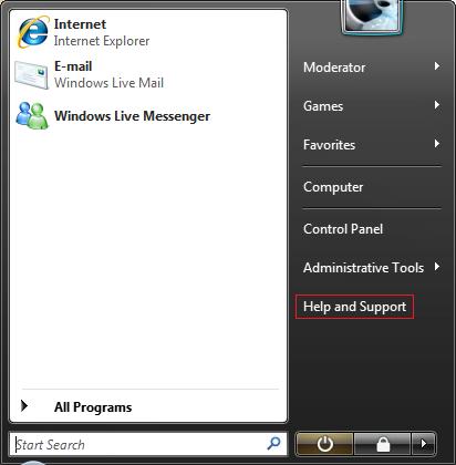

EXAMPLE: Normal Start Menu with Help and Support Added and Removed
NOTE: You can use Option One or Two below for the Normal Start menu.
EXAMPLE: Classic Start Menu with Help and Support Added and RemovedNOTE: You will need to use Option Two below for the Classic Start menu.
This will only remove the Help and Support option for the default Normal Start menu. For the Classic Start menu, see Option Two below.

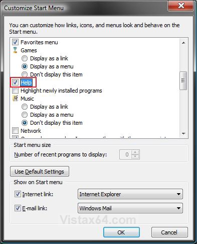

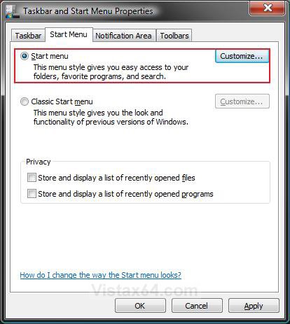

1. Right click on the Start button or on a empty space in the Start menu and click on Properties.
2. Click on the Customize button next to the selected (dotted) Start menu. (See screenshot below)
NOTE: For more about Customize and the Start menu, see: How to Customize the Start Menu in Vista
3. To Add Help and Support
A) Check the Help box. (See screenshot below step 5)
NOTE: This Help option is removed in Option Two below.
B) Go to step 5.
4. To Remove Help and Support
A) Uncheck the Help box. (See screenshot below step 5)
5. Click on OK. (See screenshot below)
6. Click OK. (See screenshot below step 2)

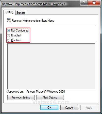

This will remove the Help and Support option on both the Normal and Classic Start menu.
This method is only available for the Vista Business, Ultimate, and Enterprise editions. See Method Two below for the Vista Home Basic and Home Premium editions.

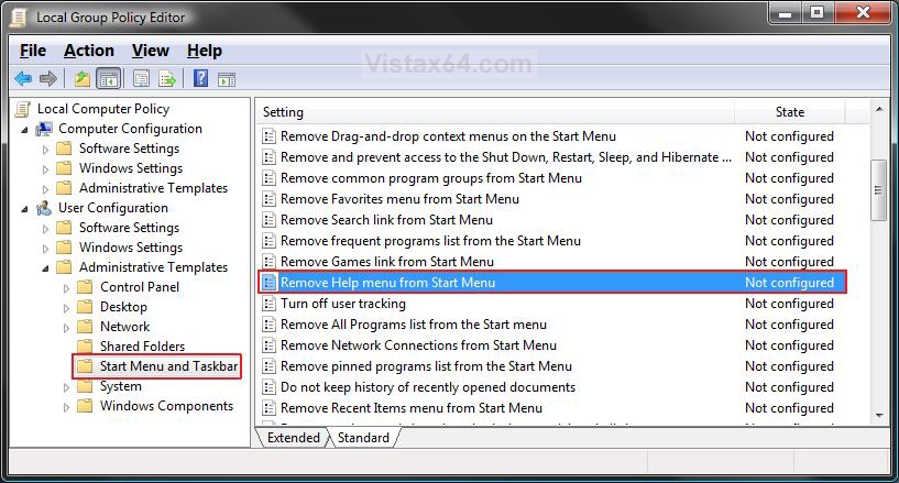

1. Open the all users, specific users or groups, or all users except administrators Local Group Policy Editor for how you want this policy applied.
2. In the left pane, click on User Configuration, Administrative Templates, and Start Menu and Taskbar. (See screenshot below)
3. In the right pane, right click on Remove Help menu from Start Menu and click on Properties. (See screenshot above)
4. To Add Help and Support
A) Select (dot) Disabled or Not Configured and click on OK. (See screenshot below 5A)
B) Go to step 6.
5. To Remove Help and Support
A) Select (dot) Enabled and click on OK.
6. Close Local Group Policy Editor window.

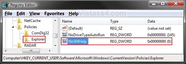

Manually in Registry Editor:
1. Open the Start Menu.
2. In the white line (Start Search) area, type regedit and press Enter
3. Click on the Continue button in the UAC prompt.

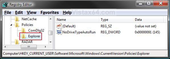

4. In regedit, go to: (See screenshot below)
Code:
[/INDENT][/INDENT]
[INDENT][INDENT]HKEY_CURRENT_USER\Software\Microsoft\Windows\CurrentVersion\Policies\Explorer[/INDENT][/INDENT]
[INDENT][INDENT]

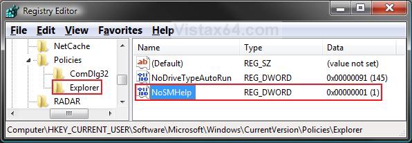

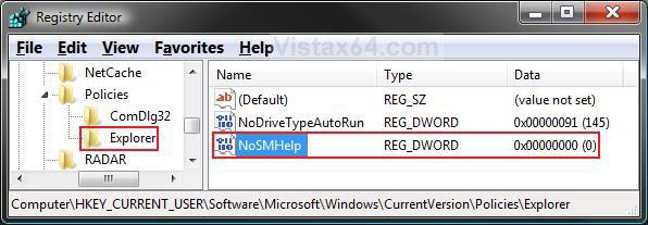

A) In the right pane, right click on a empty area and click on New and DWORD (32-bit) Value. (See screenshot above)
B) Type NoSMHelp and press Enter.

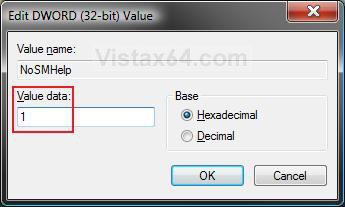

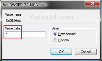

C) Right click on NoSMHelp and click on Modify. (See screenshot below)
D) Type 1 and click on OK. (See screenshot below)
E) The registry will now look like this. (See screenshot below)
F) Go to step 7.
6. To Add Help and Support
A) In the right pane, right click on NoSMHelp and click on Delete. (See screenshot above)
B) Click on Yes to confirm deletion.
7. Close regedit.
