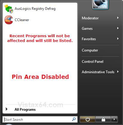

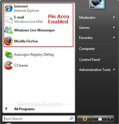

EXAMPLE: Start menu Pin area Enabled and Disabled
NOTE:
Notice how the lower half Recent Programs list in the enabled Start menu pin area is not affected when the Pin area is disabled. Only the Pinned Programs and Folders are removed at the top. If you do not have Recent Programs enabled, then the left white side of the Start menu (right screenshot) will be completey blank instead if this.

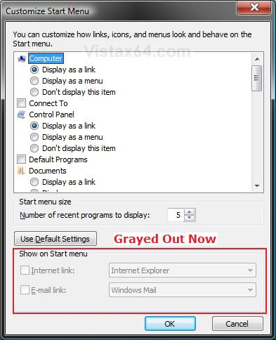

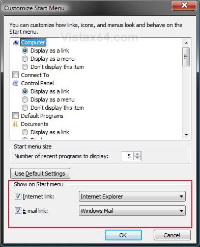

EXAMPLE: Customize Show on Start menu with Pin area Enabled and Disabled
NOTE: When the Pin area is disabled, these options boxed in red will be grayed out.

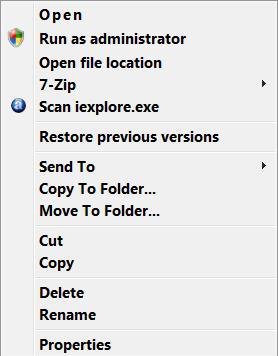

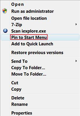

EXAMPLE: Context Menu with Pin area Enabled and Disabled
NOTE:
When the Pin area is disabled, the Pin to Start Menu context menu item is removed.

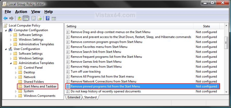

2. In the left pane, click on User Configuration, Administrative Templates, and Start Menu and Taskbar. (See screenshot below)​

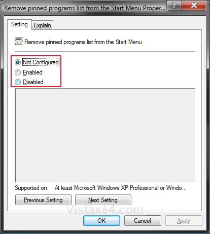

3. In the right pane, right click on Remove pinned programs list from the Start Menu and click on Properties. (See screenshot above)​
4. To Enable Pin to Start Menu
A) Select (dot) Disabled or Not Configured and click on OK. (See screenshot belowstep 5A)​
NOTE: Not Configured is the default setting.​
B) Go to step 6.​

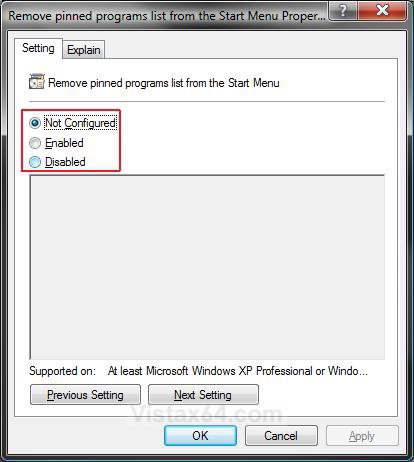

5. To Disable Pin to Start Menu

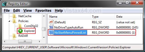

A) In the right pane of Explorer, right click on a empty area and click on New and DWORD (32-bit) Value. Type NoStartMenuPinnedList and press Enter. (See screenshot below)​

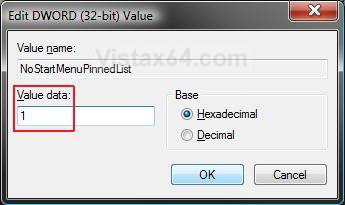

B) Right click on NoStartMenuPinnedList and click on Modify.​
C) Type 1 and click on OK. (See screenshot below)​
D) The registry will now look like this. (See screenshot below)​
E) Go to step 7.​

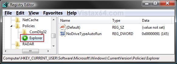

6. To Enable Pin to Start Menu
NOTE: This is the default setting.​
A) In the right pane of System, right click on NoStartMenuPinnedList and click on Delete. (See screenshot above)​
