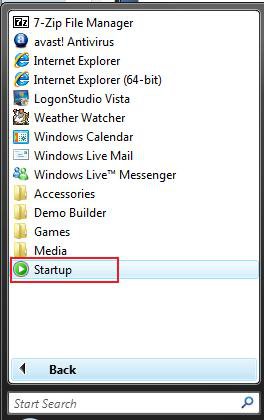

1. For the Current User Account Only
A) Open the Start Menu.​
NOTE: You can also open the Startup folder by typing shell:startup in the white line (Start Search) area and pressing Enter.
B) Click on All Programs.​

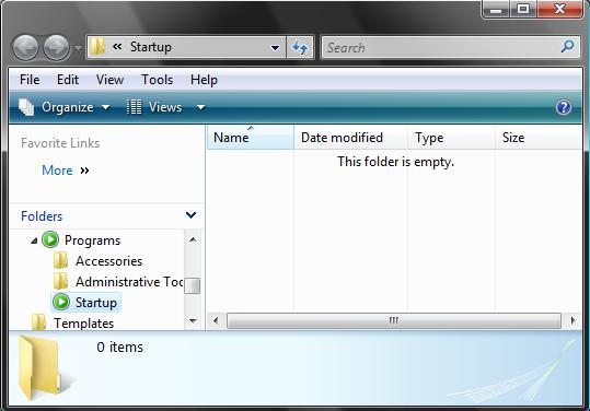

C) Right click the Startup folder and click Open. (See screenshot below)​
NOTE: This hidden folder is also located at:
C:\Users\(Username)\AppData\Roaming\Microsoft\Windows\Start Menu\Programs\Startup
D) Go to step 3.​

3. Cut/Copy and Paste a shortcut for the program you want to start at startup inside the Startup folder window. (See screenshot below)​
NOTE: If you already added a program by this method here, then you can also delete it here to remove it from startup as well. It would be best to use a shortcut that was created straight from the .EXE of the program.
4. Close Window when done.​

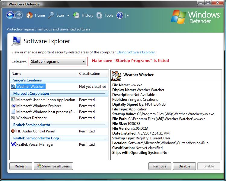

With Windows Defender
1. Open Control Panel. (Classic View)​
2. Click on the Windows Defender icon.​

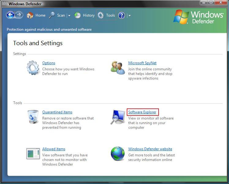

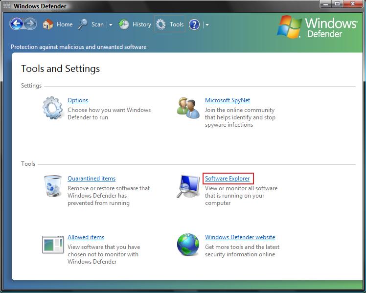

3. In Windows Defender, click on Tools at top.​
4. Click on Software Explorer. (See screenshot below)​
5. Click on the Show for all users button. (See screenshot below)​
6. Click on Continue in the UAC prompt.​
7. Under Category:, make sure that Startup Programs is selected. (See screenshot below)​
8. Select the startup program you want to change.​
NOTE: The Remove, Disable, and Enable buttons will be grayed out for Vista system programs and device drivers to prevent changes to them. You can use Device Manager for the driver programs, and also msconfig in METHOD TWO below for these. If the program is blocked, then click Quarantined items in the screenshot below step 4 to see if it is listed to be approved by you. Also check in MSCONFIG in METHOD TWO below to see if it unchecked there.

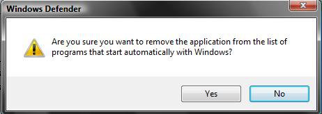

9. To Remove a Startup Program
A) Click on the Remove button. (See screenshot above)​
B) Click on Yes to the confirmation prompt. (See screenshot below)​
C) The startup program is now removed.​

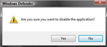

10. To Disable a Startup Program
A) Click on the Disable button. (See screenshot above step 9)​
C) The startup program is now disabled.​

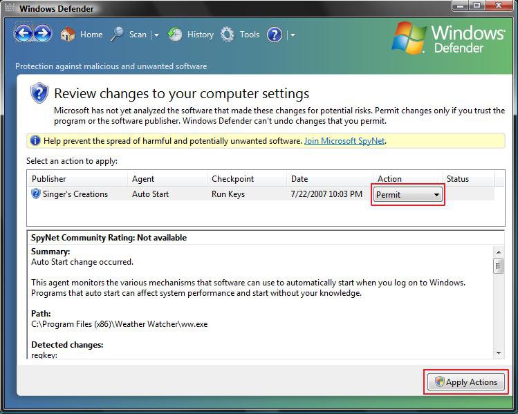

11. To Enable a Startup Program
A) Click the Enable button. (See screenshot above step 9)​
NOTE: This will only be available if you have only disabled the startup program and not removed it.
B) Click on the Windows Defender notification dialog box or icon on the taskbar. (See screenshot below)​
C) Under Action column, confirm that Permit is listed. If not, then change it. (See screenshot below)​
D) Click on the Apply Actions button.​
E) The startup program is now enabled again.​

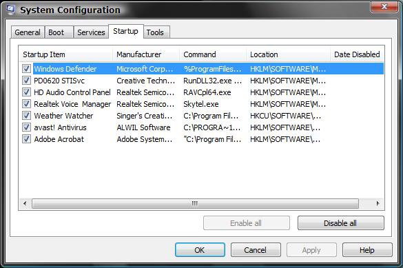

4. Click on the Startup tab. (See screenshot below)​
5. To Disable a Startup Program
A) Uncheck the startup program.​
NOTE: Click Disable all button to uncheck all startup programs.
6. To Enable a Startup Program
A) Check the startup program you already disabled (unchecked) before.​
NOTE: Click Enable all button to check all startup programs.
7. Click on OK.​

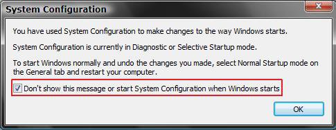

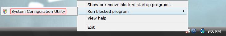

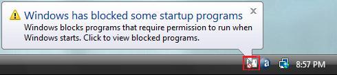

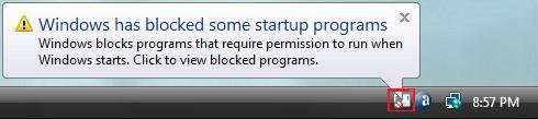

8. When the computer restarts next. You will get this message below. (See screenshot below)​
9. Click on the tray icon.​
NOTE: You will get this blocked notification everytime you restart until you check this box (Step 12 below), or Enable or Remove the startup program. Checking the box will only stop the blocked notification for these changes to the startup program. If you make more changes to the startup programs, then this blocked notification will reappear until you check the box again.
10. You will now see this menu box. (See screenshot below)​
NOTE: If you want to go to Windows Defender Software Explorer menu (See screenshot from the above section's step 8), then click Show or remove blocked startup programs.
11. Click on Run blocked program and click on System Configuration Utility.​
12. To Stop the "Windows has Blocked Some Startup Programs" and leave the startup program disabled -​
A) Check the box and click on OK. (See screenshot below step 13)​
NOTE: You will get this blocked notification (Step 9 above) everytime you restart until you check this box, or Enable or Remove the startup program. Checking the box will only stop the blocked notification for these changes to the startup program. If you make more changes to the startup programs, then this blocked notification will reappear until you check the box again.

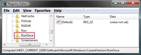

METHOD THREE:

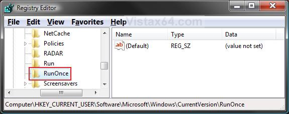

With the Registry Editor
If you want to modify only the list of legacy programs that run at Startup, use Registry Editor. If you want to add a startup program, then do the OPTION ONE section above. It is safer.
1. Open the Start Menu.​

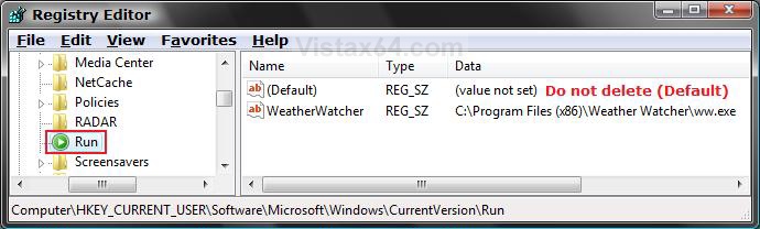

4. For Current User Only:
A) In regedit, go to: (See screenshots below step 5)​
HKEY_CURRENT_USER\Software\Microsoft\Windows\CurrentVersion\Run
AND
HKEY_CURRENT_USER\Software\Microsoft\Windows\CurrentVersion\RunOnce
5. To Delete a Startup Program
A) In the right pane, right click on the program listed that you do not want to run at startup and click Delete.​
B) Click on Yes to confirm the deletion.​

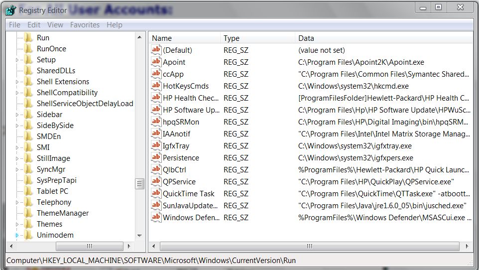

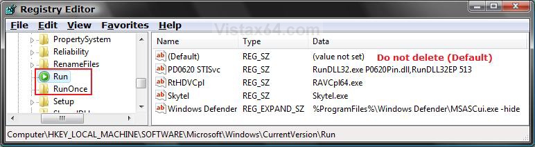

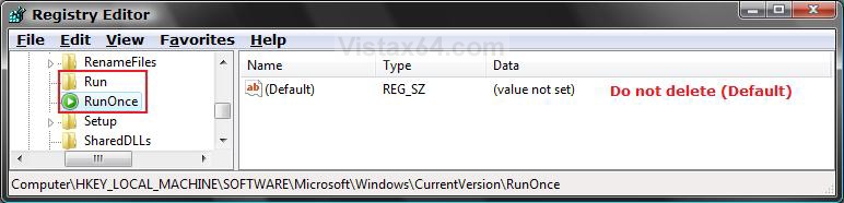

6. For All User Accounts:
A) In regedit, go to: (See screenshots below step 7)​
HKEY_LOCAL_MACHINE\SOFTWARE\Microsoft\Windows\CurrentVersion\Run
AND
HKEY_LOCAL_MACHINE\SOFTWARE\Microsoft\Windows\CurrentVersion\RunOnce
7. To Delete a Startup Program
A) In the right pane, right click on the program listed that you do not want to run at startup and click on Delete.​
8. Close regedit when done.​

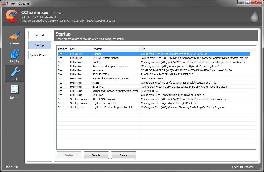

With CCleaner
1. If you have not already, download and install the free program CCleaner.​
2. Open CCleaner, and click on the Tools icon (left side) and on the Startup button. (See screenshot below)​
3. Select a startup item, then either enable, disable, or delete it from the Vista startup programs list.​
