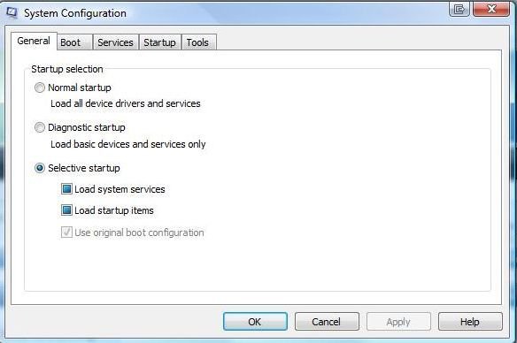

I'm not 100% sure on this 1 but a little research found me this
while you're booted in safe mode, bring up the task manager (ctrl+alt+del)
select file->new task (run) and type in
msconfig
check normal mode and OK. restart the PC
I have attached the config screen from my system for you to see(i did not do this in safe mode)

Thanks ripbox, your suggestion worked! I did have to go to one other tab and check another box but other then that your instructions worked.
