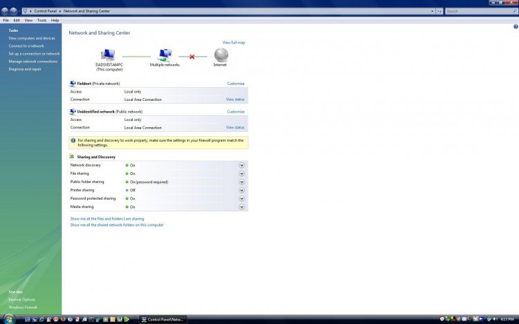

Just recently, when I boot up cold, I have no net access. When I look at network and sharing center, I have listed a private and public network. The public network is new. If I click on view status for the public network and disable it, both networks disapear from the list. I then tell system to repair and the private network comes back on and all is well.
Why is a public network suddenly showing up and how do I stop this from happening?
By the way, once I get rid of the public network and reboot the public network does not show up again, but will show up again on a cold reboot, ie, shut system down, restart, and it's there.
Also, this morning, after going through all of this, I noticed the network notification icon in the taskbar now has a little blue thingie in it's lower right hand corner and I can't for the life of me figure out what that is/what it means.
All help welcome! I am running vista ultimate 64 bit on a desktop PC. No wireless on this PC, though the router is wireless.

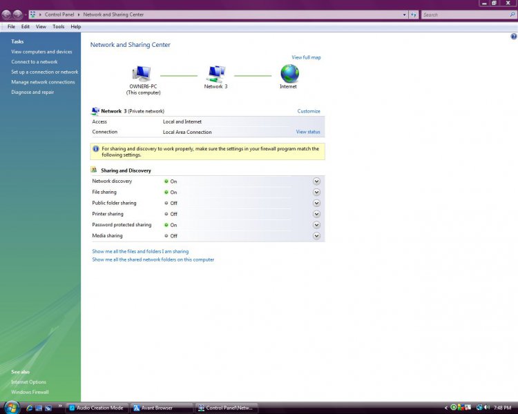

Can you provide a screenshot of your Network and Sharing Center? It should make it easyier to see whats going on and give you a better idea how to fix it also the blue thingy over the network icon shows you your local network internet status.

#4
Hey nelsonsdavis,
You attached the picture to the post correctly but the links need a web address to load the picture from like [url=http://imageshack.us]ImageShack® - Image Hosting[/url] , not your hard-drive :cool:
Im quite puzzled looking at this...Im trying to think what part of the system could cause the two profiles to be used on the one network adapter...The only thing that comes to mind is Windows Firewall with Advanced Security but im just not sure...
Instead of asking 1001 questions about your system are you able to upload a report from Belarc advisor since you allready have it installed?

Messages
18
#9
DIMEX, I saw that the Belarc advisor upload looked "funny". So, I am attaching it instead. It's a doc file.
Thanks. BTW, I use security on my wireless router and regularly check it to see the ip addresses assigned to devices to make sure no one is hacking me.
Messages
18
#10
DIMEX, btw, this issue of having a private and PUBLIC network showing up is new, ie, the system was only showing, as it should be, the private network. The public network showing up just started happening this week. I've had this system up and running for about 2 weeks now. The only thing I have done new is to plug in a multi card usb reader. But I disconnected it, did a cold reboot and made no difference (which is should not have anyway). And again, if I do a warm reboot (don't turn off power), the issue disapears. The two networks only appear on a cold boot up.
Messages
18
#11
DIMEX, problem seems to be solved. Comments you or others made about vista firewall never really being off even if I turn it off. I went into WP.MSC and turned off vista firewall for the domain, Private and Public profile, and the problem went away. BUT, still don't know why in the overview it mentions not only domain and private profile, but also public profile.
I guess having vista firewall AND Comodo firewall both running was creating problems (?). Though not really sure of that, because Comodo had been running for about a week, and this issue only cropped up maybe 3 or 4 days ago.
So, with this new info, can anyone explain exactly what was happening?
Thanks!

Hey nelsonsdavis,
You attached the picture to the post correctly but the links need a web address to load the picture from like [URL="http://imageshack.us"]ImageShack® - Image Hosting[/URL] , not your hard-drive :cool:
Instead of asking 1001 questions about your system are you able to upload a report from Belarc advisor since you allready have it installed?[/quote]
IV4 1V6
