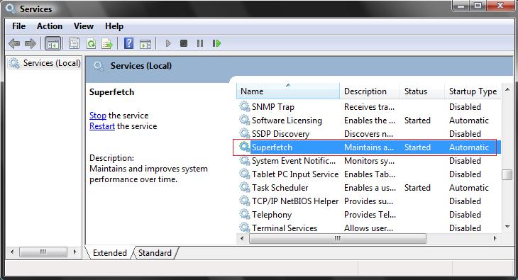

1. Open the Start Menu.​
2. In the white line (Start Search) area, type services and press Enter.​
4. Scroll down and right click on Superfetch and click on Properties. (See screenshot below)​

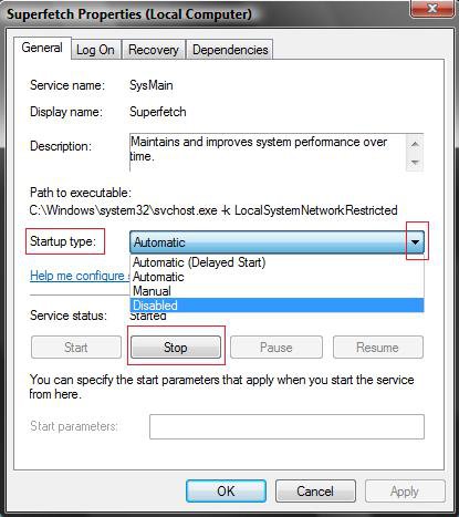

5. To Disable Superfetch
A) Click on the Stop button and click on Disabled under the Startup type: drop down menu. (See screenshot below step 6B)​
B) Click on OK.​
C) Go to step 7.​
6. To Enable Superfetch
NOTE: This is the default setting.​
A) Click on Automatic (Under Startup type) and click on the Apply button, then click on the Start button.​
B) Click on OK.​
