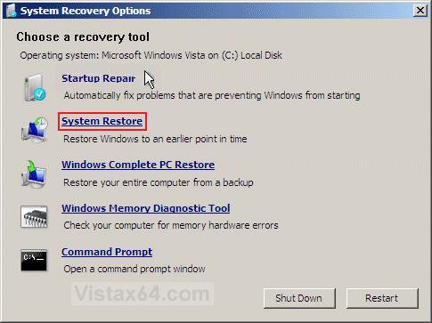

METHOD TWO
Using System Recovery Options at Boot
1. Boot from either your retail Vista installation disc or created Vista repair disc into the System Recovery Options screen.
2. Click on the System Restore option. (See screenshot below)
3. Follow the rest of the instructions in the video at step 3 on in METHOD ONE above for how to do the rest.

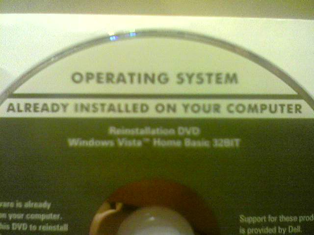

For method 2, how could one do that if the computer came with Vista already installed? Also, I have a CD that came with the computer that says:
Operating System
Already installed on Your Computer​
on the top of the disc.​
On the left hand side it says:​
The software is already installed on your computer.
Only use this DVD to reinstall the operating system on a Dell PC.
The attached picture is of the top of the disc. The other writing was too small to show up in a picture.
Operating System
Dell PC.
Right, I think the OEM disc provided by manufacturers can't do that ? Also is that an OEM disc or just a restore disc ?
