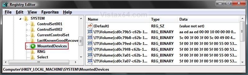

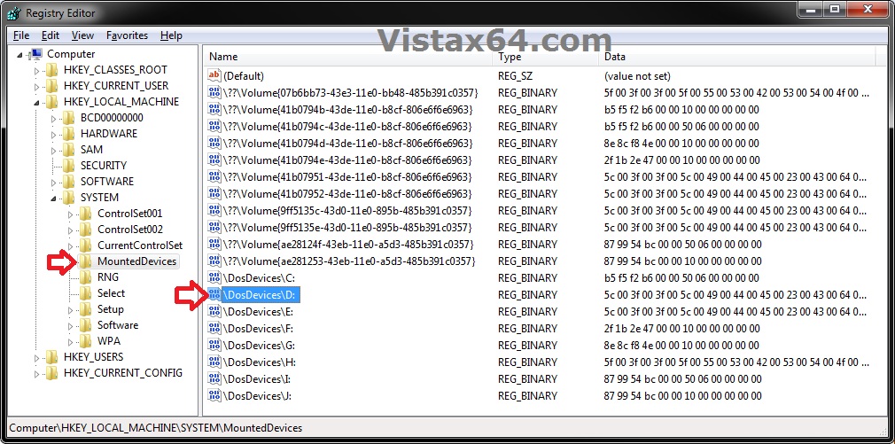

3. In regedit, navigate to the location below. (see screenshot below)​
HKEY_LOCAL_MACHINE\SYSTEM\MountedDevices

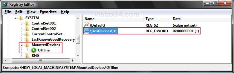

4. To Stop XP from Deleting Restore Points

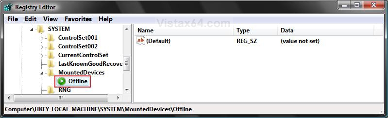

A) In the left pane, right click on MountedDevices and click on New and Key.​
NOTE: If you already have the Offline key under MountedDevices, then skip this step and go to step 4C. (see screenshot below step 4C )​
B) Type Offline and press Enter.​
C) In the right pane of Offline, right click on a empty area and click on New and DWORD Value. (see screenshot below)​
D) Type \DosDevices\D: and press Enter. (see screenshot below step 4F)​
NOTE: While in XP, if your Vista or Windows 7 is not showing as being on the D: drive in Computer, then substitute D: with the drive letter that it is shown to be on instead. For example, if it is shown to be on the E: drive, then type \DosDevices\E: instead. Repeat this step if you wish to hide another drive letter from XP.​

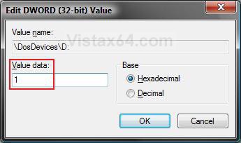

E) In the right pane, right click on \DosDevices\D: and click on Modify.​
F) Type 1, and click on OK. (see screenshot below)​
G) The registry should now look like this. (see screenshot below)​

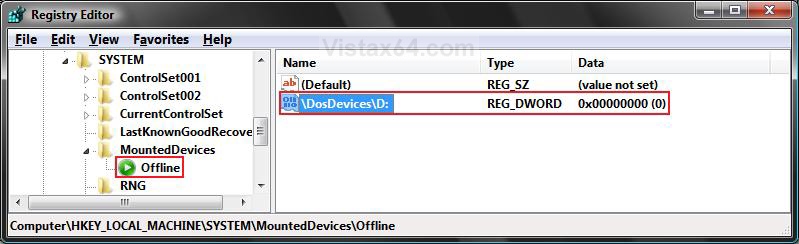

5. To Restore the Default XP Settings
A) In the right pane of Offline, right click on \DosDevices\D:, and click on Delete. (see screenshot below step 4H)​
B) Click on Yes to confirm the deletion.​
C) Repeat step 5 for any other listed drive letter that you would like XP to be able to see again.​
