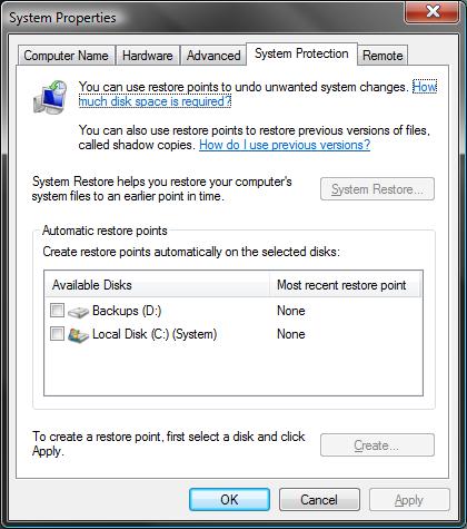

1. Open the Control Panel (Classic View)​
2. Click on the System icon.​
3. Click on the Advanced system settings link. (upper left corner)​
4. If prompted by UAC, then click on Continue.​
5. Click on the System Protection tab.​
6. To Turn On System Restore for a Drive
A) Check the Available Disk letter(s) that you want System Restore to create restore points for and stored on the same drive. (See screenshot below)​
NOTE: Each drive selected will have it's own restore points stored on only that same drive. For example, C will not be stored on D, and D will not be store on C.​
B) Go to step 8.​
7. To Turn Off System Restore for a Drive
A) Uncheck any Available Disk letter that you no longer want restore points created for. (See screenshot above)​

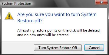

B) You will get a pop up window. (See screenshot below)​
C) Click on the Turn System Restore Off button.​
Here it is again, I hope!
When you have time can you help me. I didnt disable any of this, and Shadow Copy/Restore Point Is still active. TIA, Bare Foot kid
