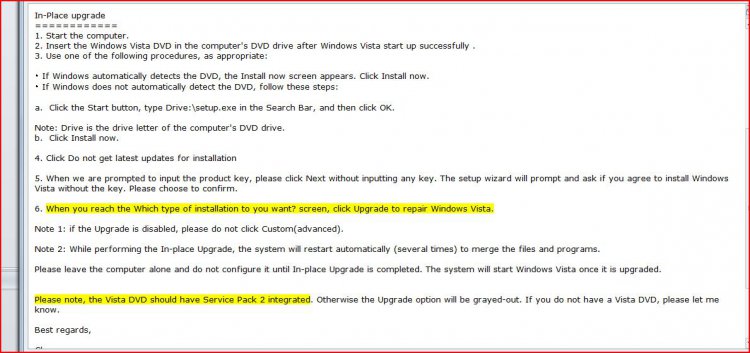

hi mr jack, a repair disc for sp1 will not work on an sp2 as i found out after getting in touch with microsft, they sent me a sp2 repair disc specifically for vista premium sp2 at no charge when i had corrupt files, good luck patch41

Using the Vista SP1 disc to only use the RE should be fine on a SP2 installation.
You cannot only use Vista SP1 to do repair (upgrade) on SP2 installation

#5
i tried using the sp1 repair disc with no luck, then i got in touch with microsoft support who sent me the repair disc with sp2 free of charge, followed the instructions and it fixed the problem, i also had corrupt files which sfc/scannow said could not be repaired, i dont know maybe your problem may be a more serious than mine,i am also a newbie,but good luck,patch41
Because you tried repair install (upgrade) thus you needed Vista SP2.
To make repair install you need to run system in normal mode but he can't.His system is stuck.
