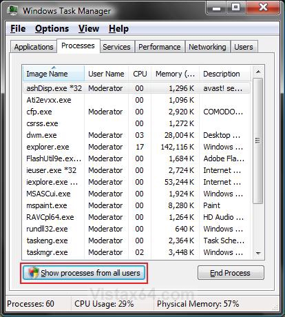

2. Click on the Process tab. (See screenshot below step 4)​
3. Click on Show processes from all users.​
NOTE: This elevates the Task Manager. If you do not this, then you will receive this error when you try to disconnect the user: User username (SessionId=2) could not be disconnected. Access is denied.​

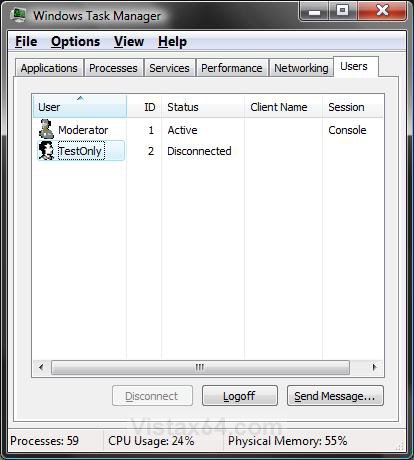

5. Click on the Users tab. (See screenshot below step 7)​
NOTE: The Users tab is unavailable on computers that are members of a network domain.​
6. Click on a user that you want to disconnect their network connection to your computer.​
NOTE: A connected network user will have their Computer Name under the Client Name column.​
7. Click on the Disconnect button.​
NOTE: This button will be grayed out if the listed user is not connected by a network and is only connected locally (EX: Switch User) instead. See: How to Log Off a Local User in Vista

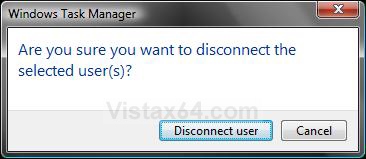

8. Click on Disconnect user to confirm. (See screenshot below)​
9. Task Manager will now no longer have the user listed since they have been disconnected.​
