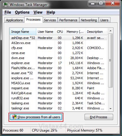

2. Click on the Process tab. (see screenshot below step 5)​
3. Click on Show processes from all users. (see screenshot below)​

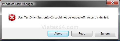

This elevates the Task Manager. If you do not this, then you will receive this error when you try to log off the user: User username (SessionId=2) could not be logged off. Access is denied. (see screenshot below)

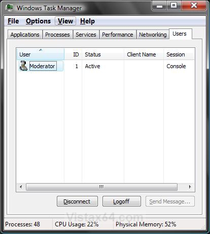

5. Click on the Users tab. (see screenshot below step 3)​
NOTE: The Users tab is unavailable on computers that are members of a network domain.​

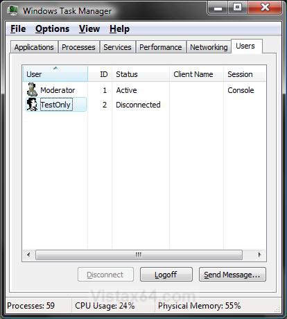

6. Click on a user that you want to log off to select it. (see screenshot below)​
7. Click on the Logoff button.​

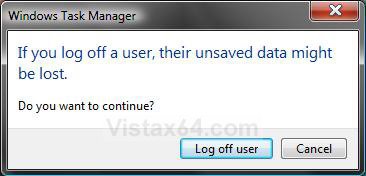

8. Click on Log off user to confirm. (see screenshot below)​
WARNING: If the user is working on something when you log them off, they may lose it.​
