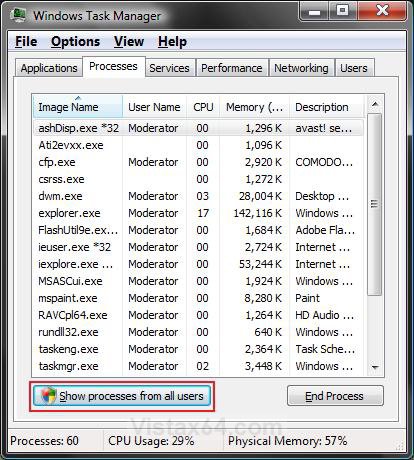

2. Click on the Process tab. (See screenshot below step 5)​
3. Click on Show processes from all users. (See screenshot below step 5)​

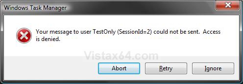

NOTE: This elevates the Task Manager. If you do step 3, then you will receive this error below when you try to send a message to the user: Your message to user username (SessionId=2) could not be sent. Access is denied. (See screenshot below)

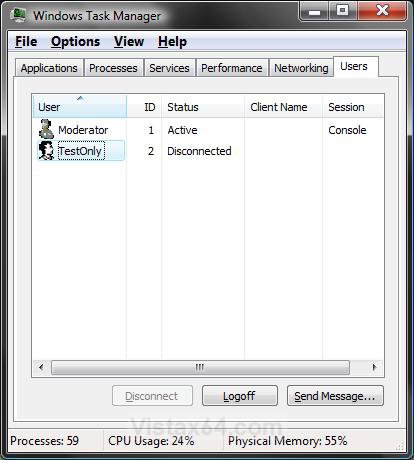

5. Click on the Users tab. (See screenshot below)​
NOTE: The Users tab is unavailable on computers that are members of a network domain.​
6. Click on a user that you want to send a message to. This will highlight the user. (See screenshot below)​
7. Click on the Send Message button.​

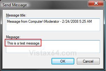

8. Type in a Message title, then the Message. (See screenshot below)​
9. When done, click OK to send the message.​

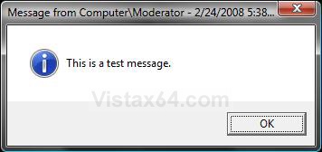

10. The user will then recieve a pop-up window with your message title and message in it. (See screenshot below)​
NOTE: When done reading the message, they can click OK to close the message window.​
WARNING: This message will not stay on top of other opened windows, so it may get hidden behind the other windows. Look in the taskbar to see the tab for it to make it easier to spot and open to read.​
