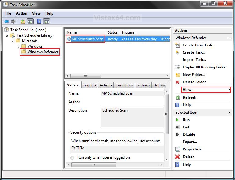

4. In the right pane, click on View and click on Show Hidden Tasks to check it. (See screenshot below step 7)​
5. In the left pane, click on the arrow on the Task Scheduler Library folder, Microsoft folder, and Windows folder to expand them.​
6. Click on the folder for the existing task you wish to change.​
NOTE: For example, the Windows Defender folder, or one that you have created from OPTION ONE above.​
7. In the middle pane, right click on the listed MP Scheduled Scan and click on Properties.​

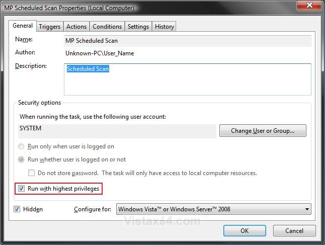

8. Under the General tab, check the Run with highest privileges box. (See screenshot below)​
9. Select (dot) Run whether user is logged on or not.​

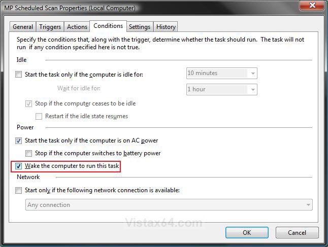

10. Click on the Conditions tab and check the Wake the computer to run this task box. (See screenshot below)​
NOTE: For more details on the other options, see the Step Seven section here: How to Create a Task in Vista Task Scheduler
If you want to stop a task from waking up the computer than uncheck the Wake the computer to run this task box.​

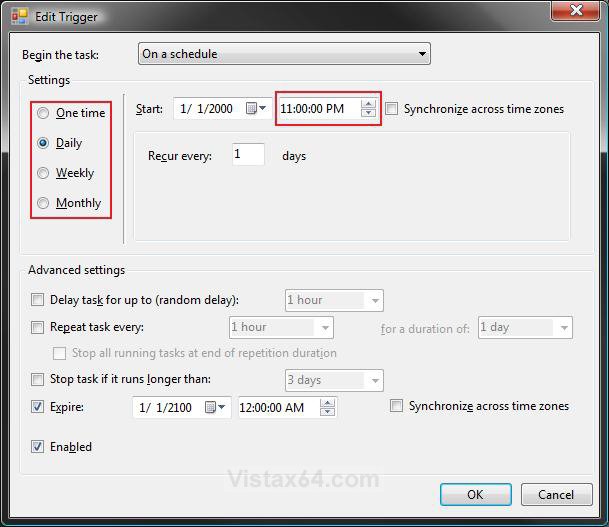

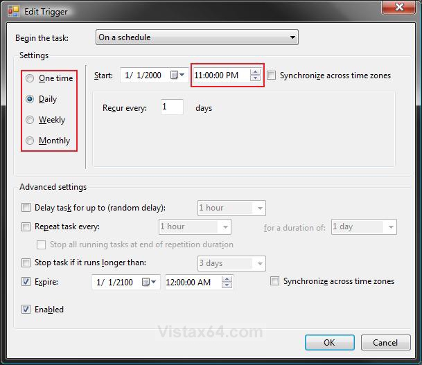

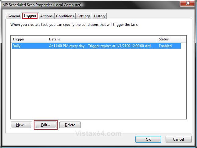

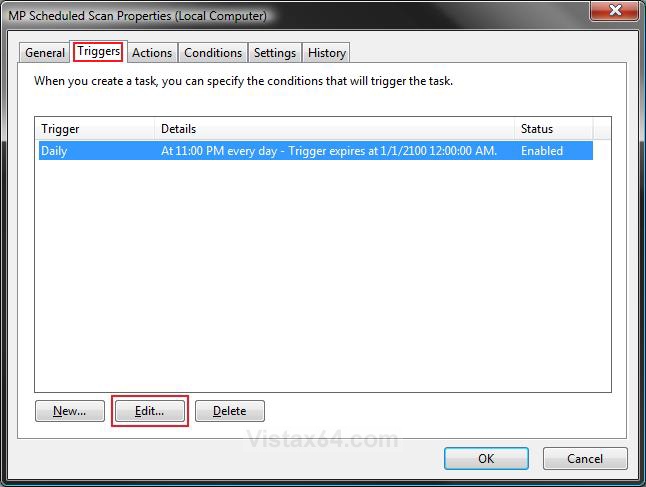

11. Click on the Triggers tab and click on the listed trigger that you wish to change to highlight it. (See screenshot below step 12)​
12. Click on the Edit button.​
13. Change the schedule to when and how you want the task to run. (See screenshot below)​
NOTE: For more details about these options, see the Step Five section here: How to Create a Task in Vista Task Scheduler
14. When done, click on OK. (See screenshot above)​

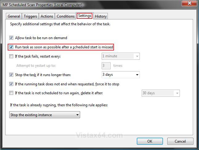

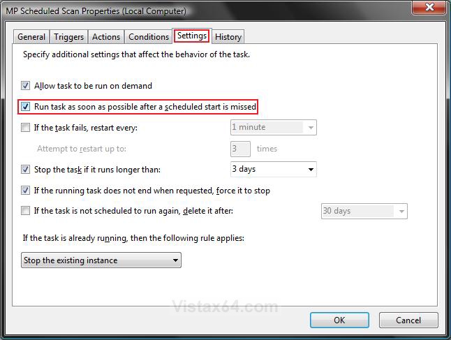

15. Click on the Settings tab. (See screenshot below step)​
16. Check the Run task as soon as possible after a scheduled start is missed box.​
NOTE: This will allow the scheduled task to run the next time you have the computer awake and running if the scan was missed due to it not being able to run at it's scheduled time or failed the attempt to restart in step 17.​
17. Check the If the task fails, restart every box.​
A) Select how often and how many times you want the task to attempt to run again if it failed to run when scheduled for some reason.​
NOTE: For more details on the other options, see the Step Eight section here: How to Create a Task in Vista Task Scheduler
18. Click on OK to apply changes. (See screenshot above)​
