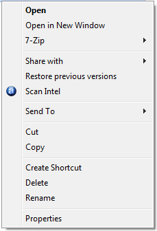

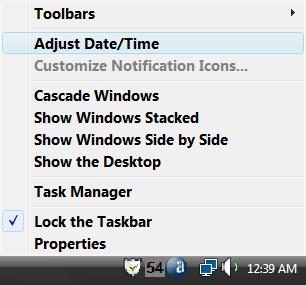

EXAMPLE: Start Menu and Button, Taskbar and Taskbar Buttons, and Clock Context Menus

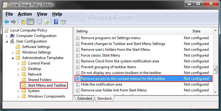

2. In the left pane, click on User Configuration, Administrative Templates, and Start Menu and Taskbar. (See screenshot below)​
3. In the right pane, right click on Remove access to the context menus for the taskbar and click on Properties. (See screenshot above)​

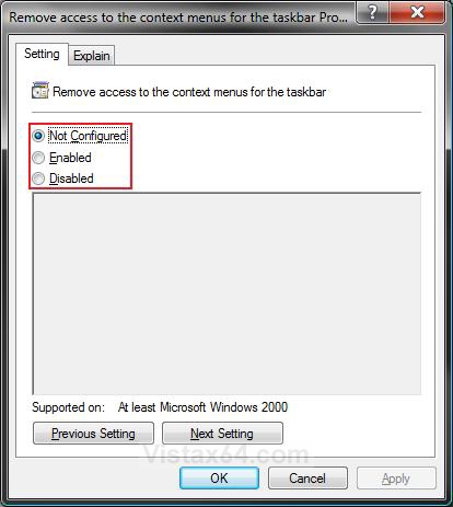

4. To Enable Taskbar Context Menus
A) Select (dot) Disabled or Not Configured, then click on OK. (See screenshot below step 5A)​
B) Go to step 6.​
5. To Disable Taskbar Context Menus
A) Selec (dot) Enabled and click OK.​

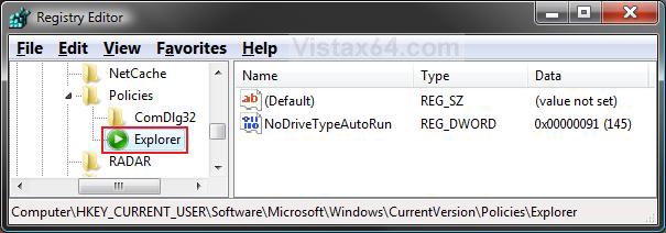

1. Open the Start Menu.​

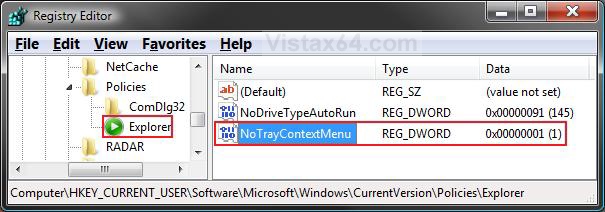

A) In the right pane, right click on a empty area and click on New and DWORD (32-bit) Value. (See screenshot above)​
B) Type NoTrayContextMenu and press Enter.​

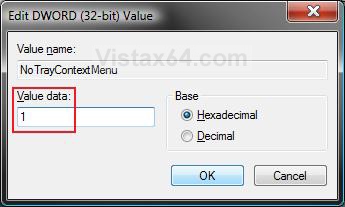

C) Right click on NoTrayContextMenu and click on Modify. (See screenshot below)​
