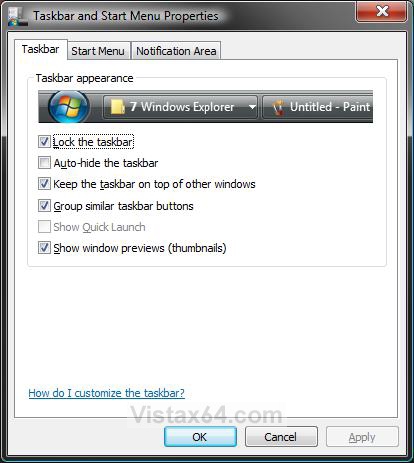

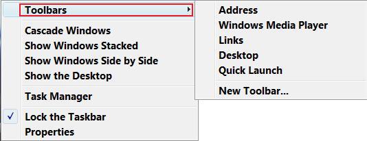

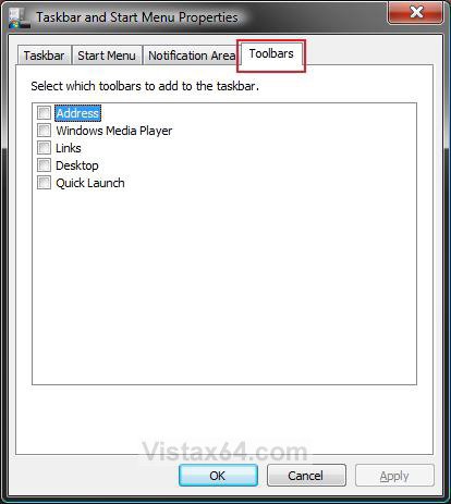

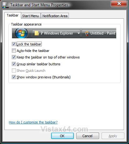

NOTE: You can see this window by right clicking on the taskbar, Start menu button, or inside the Start menu and click on Properties.

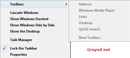

EXAMPLE: Toolbars Enabled and Disabled in the Taskbar Right Click (Context) MenuNOTE: If Toolbars is missing and not grayed out, then see this link instead: How to Enable or Disable Taskbar Toolbars in Vista

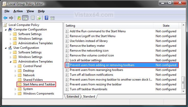

1. Open the all users, specific users or groups, or all users except administrators Local Group Policy Editor for how you want this policy applied.
2. In the left pane, click on User Configuration, Administrative Templates, and Start Menu and Taskbar. (See screenshot below)

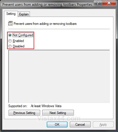

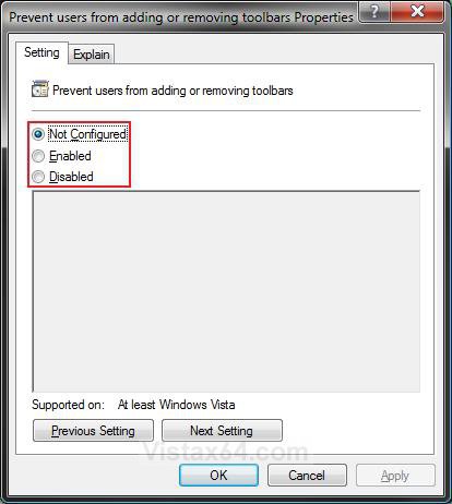

3. In the right pane, right click on Prevent users from adding or removing toolbars and click on Properties. (See screenshot above)

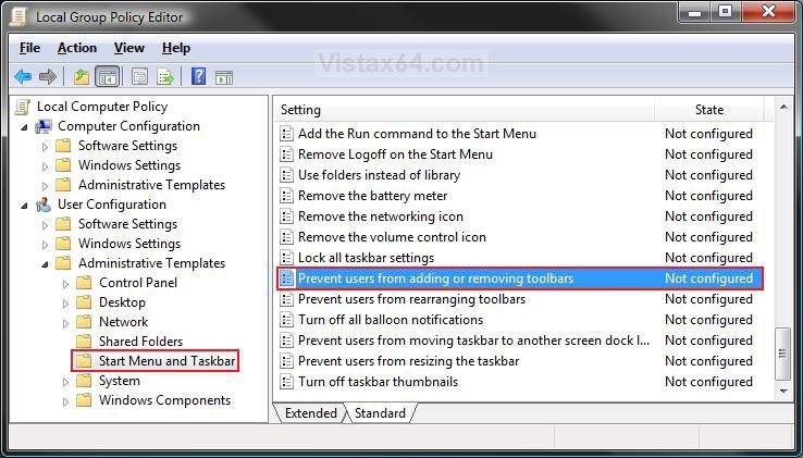

4. To Enable Adding and Removing Taskbar Toolbars
A) Select (dot) Disabled or Not Configured and click on OK. (See screenshot below 5A)
NOTE: Not Configured is the default setting.
B) Go to step 6.
5. To Disable Adding and Removing Taskbar Toolbars
A) Select (dot) Enabled and click on OK.
6. Close Local Group Policy Editor window.

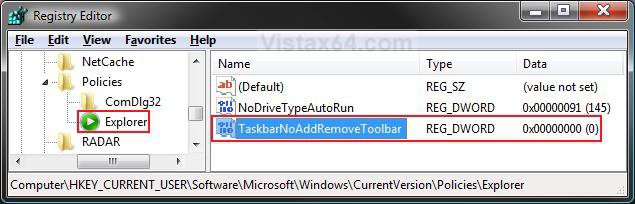

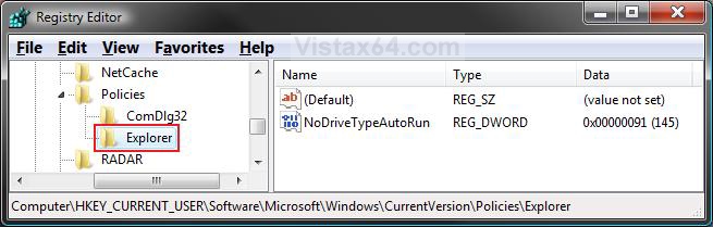

4. In regedit, go to: (See screenshot below)

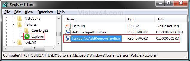

A) In the right pane, right click on a empty area and click on New and DWORD (32-bit) Value. (See screenshot above)
B) Type TaskbarNoAddRemoveToolbar and press Enter.

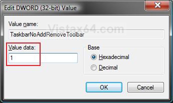

C) Right click on TaskbarNoAddRemoveToolbar and click on Modify. (See screenshot below)
D) Type 1 and click on OK. (See screenshot below)
E) The registry will now look like this. (See screenshot below)

6. To Enable Adding and Removing Taskbar Toolbars
NOTE: This is the default setting.
A) In the right pane, right click on TaskbarNoAddRemoveToolbar and click on Delete. (See screenshot above)
B) Click on Yes to confirm deletion.
