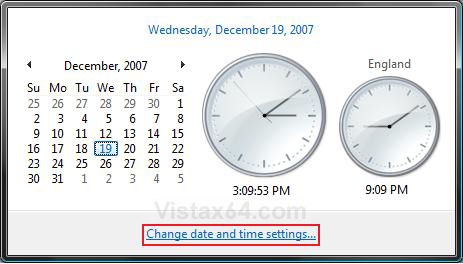

Click on Clock
1. Click on the clock on the taskbar. (See screenshot below)​
2. Click on Change date and time settings. (See screenshot below)​
3. Go to step 3 in OPTION TWO below.​

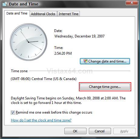

1. Right click on the clock on the taskbar. (See screenshot below)​
2. Click on Adjust Date/Time. (See screenshot below)​
3. Click the Change time zone button. (See screenshot below)​

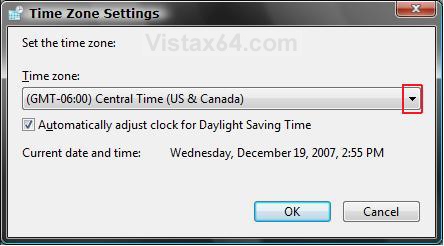

4. Change the Time zone to the correct one for your region. (See screenshot below)​
NOTE: If your time zone observes daylight saving time and you want your computer's clock to be adjusted automatically when daylight saving time changes, make sure the Automatically adjust clock for Daylight Saving Time check box is selected.​
5. Click on OK to apply the changes.​
6. Click on OK. (See screenshot below step 3)​
