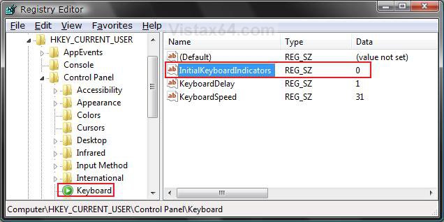

4. In regedit, navigate to the location below. (see screenshot below)​
HKEY_CURRENT_USER\Control Panel\Keyboard

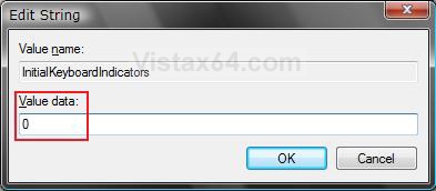

5. In the right pane, double click/tap on InitialKeyboardIndicators to modify it.​
6. Type in a number in the table below for what you want, and click/tap on OK. (See screenshot below table)​

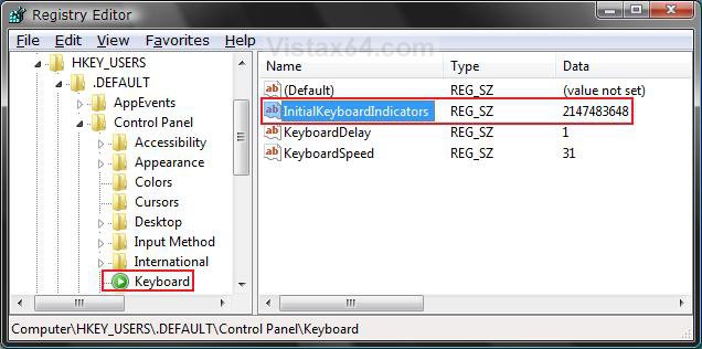

3. In regedit, navigate to the location below. (see screenshot below)​
HKEY_USERS\.Default\Control Panel\Keyboard
4. In the right pane, double click/tap on InitialKeyboardIndicators to modify it.​

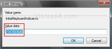

5. Type in a number below for what you want, and click/tap on OK. (See screenshot below table)​
NOTE: It is safe to change this longer default number 2147483648 (decimal equivalent of 0x80000000). It acts the same as 0.
