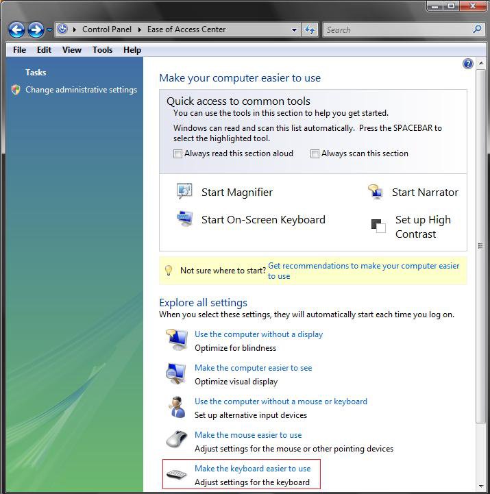

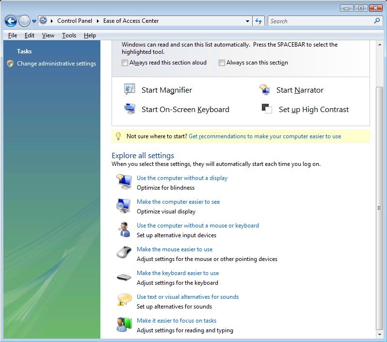

2. Click on the Ease of Access Center icon.​
3. Click on the Make the keyboard easier to use link. (See screenshot below)​

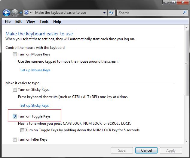

4. To Turn Toggle Keys On
A) Check Turn on Toggle Keys. (See screenshot below step 6)​
NOTE: Check Turn on Toggle Keys by holding down the NUM LOCK key for 5 seconds to be able to turn toggle keys ON or OFF manually.
B) Go to step 6.​
5. To Turn Toggle Keys Off
A) Uncheck Turn on Toggle Keys. (See screenshot below step 6)​
6. Click on the Save button.​
7. Close window from below step 3.​
