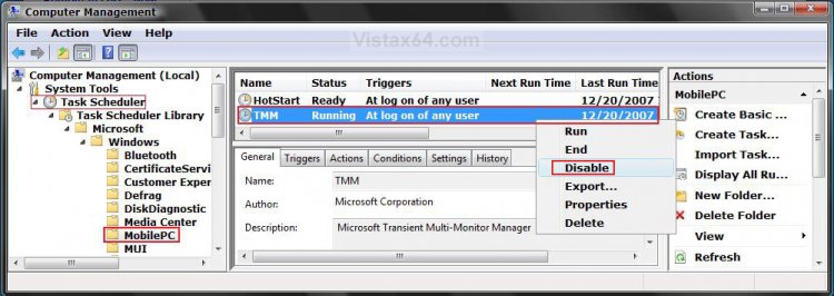

3. In the left pane, expand Task Scheduler, Task Scheduler Library, Microsoft, Windows, and click on MobilePC. (See screenshot below)​
4. In the middle pane, right click on TMM.​
5. To Disable TMM
A) Click on Disable.​
B) Go to step 7.​
